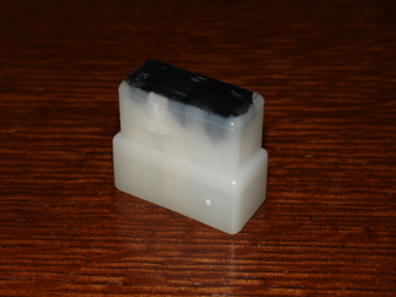

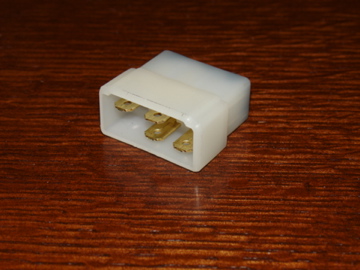

Good news in several ways! I've hooked up with a source that will make the "Plug-N-Play 240Z Alternator Upgrade Adapter" to my specs. And the production version is frankly better in many ways than I had hoped.
1.) It is now the small, weather-resistant and self-contained unit I had originally envisioned. (See pictures below.)
2.) It is made with a factory-style connector, and new brass terminals. The necessary diode is self-contained.
3.) Better yet, the final version is cheaper than I had thought it could be made. The final price is $15.00 each, INCLUDING postage within the US. Contact me for shipping outside the US. A small volume discount is available for quantities of 10 or more. Contact me for that as well.
So here's the scoop - I can only do this via money orders at this time. PM me for the address to mail it to. Figure 7-10 days turn-around (plus first class mail delivery) once I receive payment.
Here are the pictures, and the instructions. (Instructions will not be printed and shipped with the adapter, to hold down on costs. Please download it here instead.) The alternators that I know for a fact will work are from '81-83 280ZX, both turbo (70 amp) and non-turbo (60 amp). I've been told that other Nissan alternators may work as well (Maxima, etc.) but can't verify that.

Arne:
At this price, I think that you have a viable product here.
I'll be ordering a couple of them in a few weeks.
Are you producing them on an "as ordered" basis, or do you plan to have some quantity "in stock" to fill orders?
Just to clarify - these adapters are for 240Z's wishing to use the '81-83 internally regulated 280ZX alternator. Later 260 and 280Z's are not supposed to need these. Other Nissan alternators may work as well, but I can't confirm that.

Damn Arne, Great idea!!! Kinda Makes me wish that I had thought of it..:cheeky:
Looks very clean and also looks like I could even hide it between the engine harness and the frame rail without any one seeing it. NICE......
Dave.
Thanks for the kind words, Dave. Your help and support during the trek to get here has been invaluable. These parts wouldn't be available today without your help.
