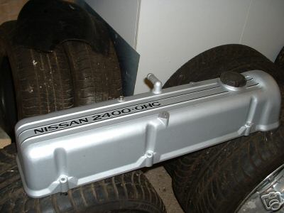

Saw this on Ebay, starting bid seems to be pretty high. Just curious, what are these generally worth... this one looks to be in good condition:
http://cgi.ebay.com/ws/eBayISAPI.dll?ViewItem&rd=1&item=4620633447&ssPageName=STRK:MEWA:IT
https://www.classiczcars.com/forums/topic/19175-old-series-i-valve-cover/
I don't know but I've seen them fetch some pretty high prices. I have one here that I bought from the junkyard for 8 bucks about 10 years ago. (not for sale) I think the one that says "NISSAN" in block letters is even rarer at least in the US. That one on eBay is actually a little 'over restored'.
Looks a little over pollished
Speaking of, what's the best way to bring back the factory look, and keep it looking that way too. I want mine to look right, but don't want to have to spend a lot of time keeping it looking good over time. After all, my goal is to use my car as a driver. Maybe not every day, but most of them at least.
The letters look either painted or polished. To get that uniform of a texture for the rest of the cover, it would either have to be painted, brand new, or blasted. Frankly, like all eBay pictures IMO, it's hard to tell what's up with the finish. I looks odd. That's all. If you paid the starting price and the shipping to America, it would be the all time record price for one of these that I have heard of. I have seen them go to $200 and believe that they are very popular in Japan. I think the most I ever paid for one was $25. The "OIL" cap as well as the "710" cap are correct for this valve cover. Watch out mixing caps and valve covers. The O-rings are different. Any used valve cover is going to show mechanics marks and scratches from use. They are cast aluminum and quite soft. They typically have odd casting marks and flash, and the aluminum is not uniform in color. The original grind marks from removing mold flash are rough. In other words, they were never uniform and perfect like you would get from a nice walnut shell blasting. Blasting your valve cover is not a good idea for your engine because dust gets inside the baffel. To properly clean a valve cover, take it down to your local machine shop and have them dip it. Tell them it's aluminum and they should know what to do. It will come back in a lovely natural buff. I polished the one in my avatar. Block sanded to get the casting ripples out the surfaces smooth. It's perfect and I'm going to paint it wrinkle black with polished lettering and accents.
