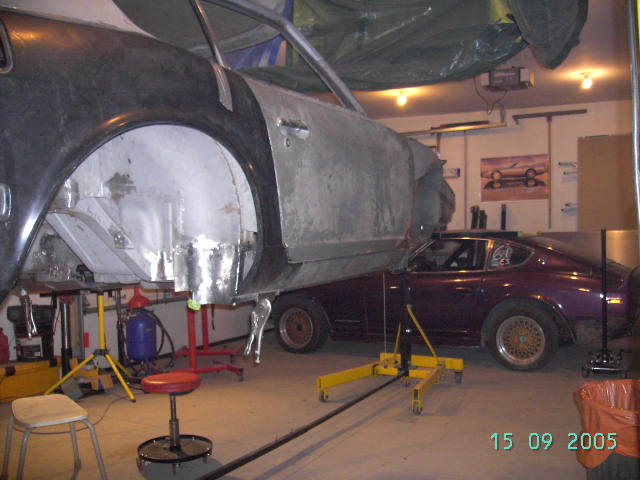

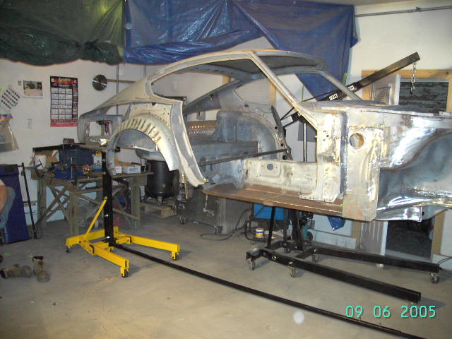

March 18, 200619 yr Author comment_159819 good info after looking at a few other designs ive made some changes to my roll cage. in passing , here is my rotissery, i built for 4000lbs , using engine stands. Link to comment https://www.classiczcars.com/forums/topic/19185-240z-gt2/?&page=2#findComment-159819 Share on other sites More sharing options...
March 18, 200619 yr comment_159825 Looks familiar. Except yours looks nice, and mine looks like some jackass is using engine stands as a rotiserrie! What all are you doing underneath? Whatever it is, I'm sure you'll agree that having the rotisserie sure makes it nicer. Link to comment https://www.classiczcars.com/forums/topic/19185-240z-gt2/?&page=2#findComment-159825 Share on other sites More sharing options...

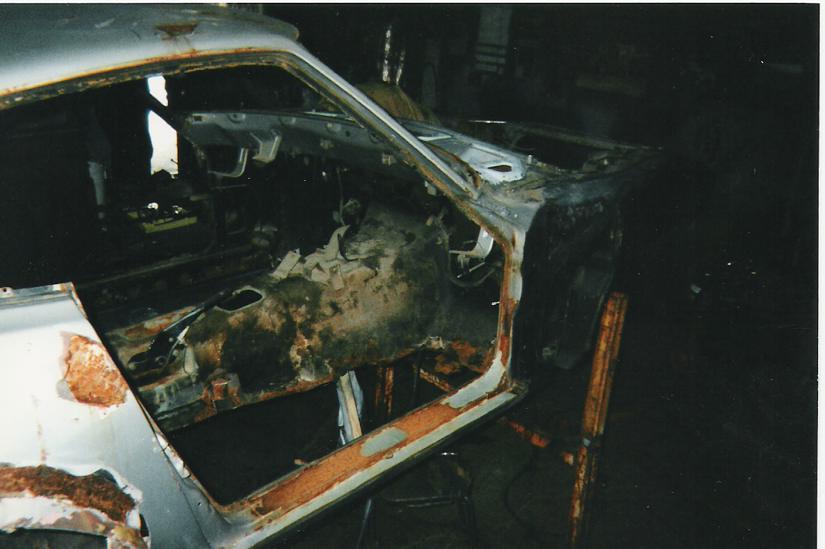

March 18, 200619 yr Author comment_159828 found this other car a few years ago by chance , frozen in somone's flooded backyard, the car was literally put on ice for a while. i paid for the car, but then had to wait for the spring thaw to retreive it out of the water . complete with original motor. serial number 00127 production 1969. im doing the whole car. basically everything, the bottom 6 inches front to rear was literally missing or rotted . i had another donor car for a few parts but fabricated most from scratch including subframes and crossmembers. the car was only worth saving cause of the serial number. i ve been working on it on and off for the last 8 months . the roster makes it so much easier before and after (so far) cheers! Link to comment https://www.classiczcars.com/forums/topic/19185-240z-gt2/?&page=2#findComment-159828 Share on other sites More sharing options...
March 18, 200619 yr comment_159841 I had a rotisserie built for my 240. I did not know how much easier it was to work on the car until I had it "up". I took it to the body/paint shop on the rack. The body guy had never worked on a car "up". He said it made a huge difference in working on and painting the car. The underside is just a neat as the top side! I left it for another guy who is painting his 240. Might as well use it rather than letting it sit in storage. Looking at yours makes me almost want to do anther one. Almost! You are doing a nice job of restoration. Another one saved! Link to comment https://www.classiczcars.com/forums/topic/19185-240z-gt2/?&page=2#findComment-159841 Share on other sites More sharing options...

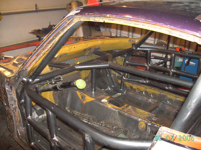

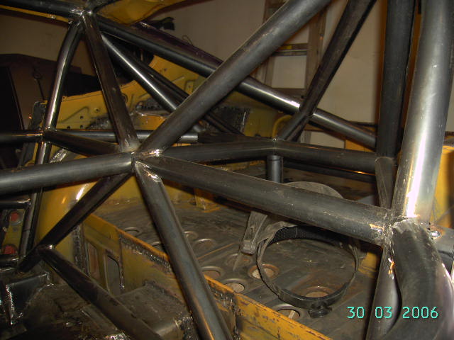

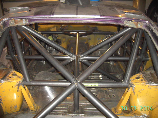

March 30, 200619 yr Author comment_161735 the cage is just about done the rear shock towers wont be going anywheres next week we start painting cheers! Link to comment https://www.classiczcars.com/forums/topic/19185-240z-gt2/?&page=2#findComment-161735 Share on other sites More sharing options...
March 30, 200619 yr comment_161738 Think you got enough structure there? How much weight did you add with all those bars? Link to comment https://www.classiczcars.com/forums/topic/19185-240z-gt2/?&page=2#findComment-161738 Share on other sites More sharing options...
March 30, 200619 yr comment_161742 Well, it will be strong. But you could have made it lighter and it would have been just as strong. For instance, having the X frame behind the driver. One diagonal bar would have stiffened the bar and car. The other brace is superfulous. The X that goes to the rear of the car is of no purpose. There is nothing back there to attach to. Sheet metal just does not need to be stregthened for safety sake. I guess if you race at Daytona and go 200 mph, it will be a great cage! Consider your driver to be safe from everything except fire. Link to comment https://www.classiczcars.com/forums/topic/19185-240z-gt2/?&page=2#findComment-161742 Share on other sites More sharing options...
March 30, 200619 yr Author comment_161752 in all there is 130 ft of cage .@ almost 2lbs per foot = approx 250lbs of tubing . the extra cross adds about 30 lbsbut its added safety for the fuel cell. in case of a bump in the rear.oh well .there it is. we ll see how it performs in a few weeks. cheers! Link to comment https://www.classiczcars.com/forums/topic/19185-240z-gt2/?&page=2#findComment-161752 Share on other sites More sharing options...
