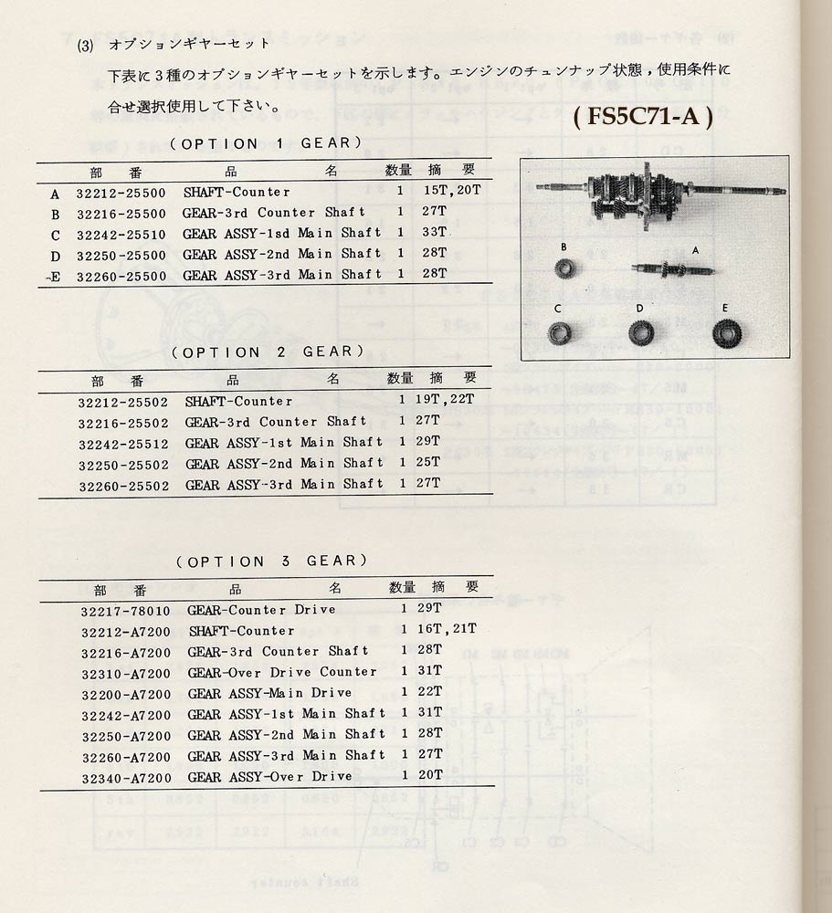

Carl,
Comparing notes with transmissions used on the Roadsters is interesting but possibly misleading. Another one of those American vernacular habits I often point out ( like calling the L24 "a 510 engine with two extra cylinders added" ) is to call the FS5C71-A - as seen on S30-series Z cars from 1969 - except the HLS30U - a "Roadster" transmission. In fact it wasn't really, was it?
Go down that road and you'd have to call the F4W71-A transmission used on the HLS30U a 'Laurel' or 'Skyline' transmission.....
Easiest thing for me to do regarding tooth counts etc is show you more pages from the Nissan Sport Service transmission manual, which has some nice tables and schematics in it. See two scans below for the tooth counts and 'Option' gear part numbers:
And the part number for the standard ( 2.957 ) 1st gear in S30-series Z FS5C71-A use was:
*32242-25511 arse'Y-GEAR, 1st speed main shaft ( 34t ).
