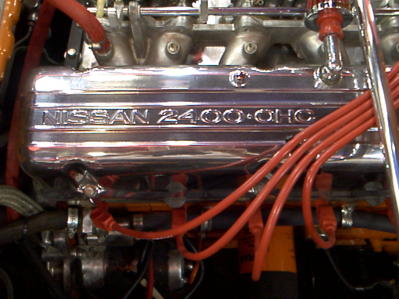

March 21, 200619 yr comment_160223 This is what the Nissan 2400 OHC looks like..... Link to comment https://www.classiczcars.com/forums/topic/19264-valve-cover-differences/#findComment-160223 Share on other sites More sharing options...
