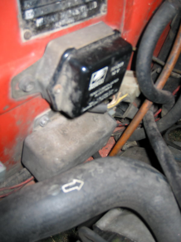

I've heard that these cars have problems with regulators and these symptoms point to it.
Any comments? How does the regulator work and where is it? I've provided some pics below of where I think the problem might be!???????????

the regulator is the one on the black there.... they are external on the 74 260z..... just call warren see if he has a spare one lyin around i bought one from him for $15 bucks.,... you can't repair them....
not sure how much a newer one from a shop, or nissan would be...

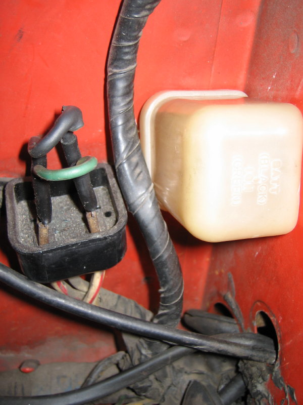

Got home just as it was getting dark and had a quick play around with what I think is the fusable link. Results are good seeing the car kicked over and started first turn of the key and kept starting reliably. I'll take a better look tmrw but just to be sure I've taken a photo of what I think is the fusable link.
Any comments guys? Is this the fusable link?

If the link is bad ( or burned) it will be brittle inside if you try to flex it. The green colored ones might turn to black ( burned outside).
Make sure the connectors are clean too. Use a little dielectric grease and make sure the cover fits well.
Just don't forget to find out why things weren't working! Even if it's just a loose connection. If the link was burned, you have a potentially serious problem and need to be diagnosed.
