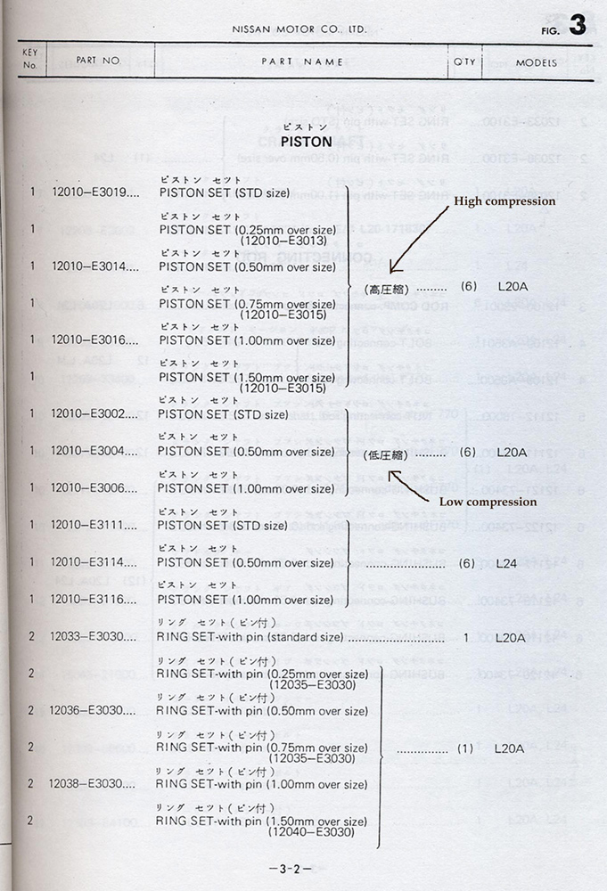

Here's a scan of a page from a Nissan factory parts manual for your reference. A good Nissan dealer in the USA ought to be able to follow up on these numbers and find the superseding numbers ( where applicable ). Watch out for 'high' and 'low' compression pistons ( I marked them accordingly ) - but I'd go for 'high' anyway, although be careful that you have a matching distributor.

My 1972 FSM lists the L20A in addition to the L24. It shows a compression ratio for the L20A of 8.6:1. The models given are the (L)230Q(U) "Datsun 200C" and the L230QT "Deluxe". It does later show the L20A as having a single carb. The standard piston diameter for the L20A is listed as 77.92-77.97mm versus 82.99-83.04mm for the L24.
