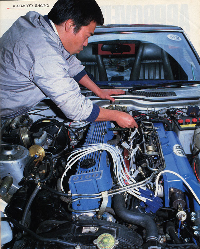

March 26, 200619 yr comment_160995 Hi Ron ( and Jim ), I have a little info on the man and the company. Maybe you would like some photocopies of what I have. I can post them to you by Air Mail. Let me know. As for the particular head in question - data on that will be one of those 'how long is a piece of string' type questions. I should imagine there are certain details that conform to the Kakimoto Racing 'menu', but you'd also have to imagine that a certain amount of 'bespoke' work might be possible. You should at least be able to measure what you have got ( valve sizes, cam specs, combustion chamber cc etc ) and get an idea of what it was built for. The 50mm Mikunis are a clue that it was most likely built for a 3.1 conversion ( Kakimoto's stock in trade back in the late Seventies and early Eighties) using an LD28 crank, L14 rods and Honda XL500 motorcycle pistons. High probability that it was a 'street drag' engine, too. Kakimoto built his reputation in Japanese 0-400m competitions. Some pics: Link to comment https://www.classiczcars.com/forums/topic/19370-kakimoto-n42/#findComment-160995 Share on other sites More sharing options...
