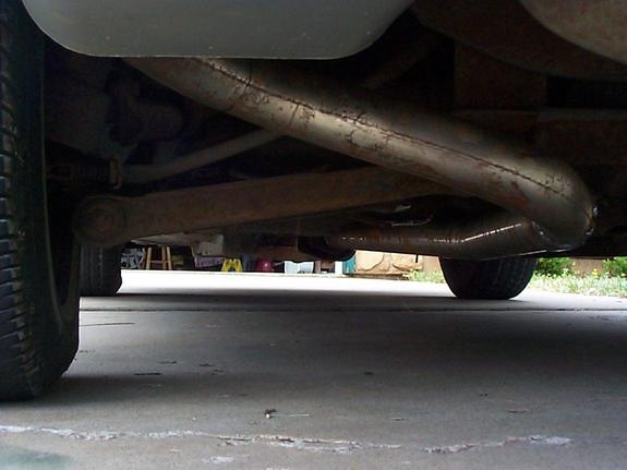

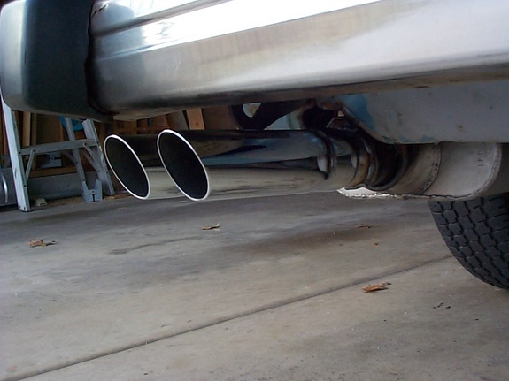

I had a shop fab me an exhaust almost all the way back. All welded and muffler installed for $85. Its a 2.25" pipe and it seems to work fine for me. The muffler is a Flowmaster Delta 40 series and it costed about $85 too. Factor in $20 for the chrome dual tip and it all comes to $190. Not too bad I think. Big improvement over what I had before.

Well, initially I planned on keeping the pre-muffler, but when I picked up the car, It had been removed. I was afraid it was going to be too loud, but its just fine really. I think it sounds great. Deep and crisp. I can really tell the car breathes better now and I'm glad I had the pre-muffler pulled. The nice thing about the Delta type mufflers is they make less interior noise. You can still hear it, but it isn't too loud at all. Even with the windows down it isn't bad at all.
That looks good. How is it working out, having the muffler flat? Are you oncerned about heating the gas tank? Probably no concern as long as you keep moving- fast!:P
Do you know the # for that tip?

Well, I had it put on last July, and since then there have been no problems at all. I had heard some things about possible heat issues, but so far there has been nothing and I drove it out in the 102 degree Kansas heat with no problems. As far as the tip goes, I really don't remember the #. I think earlier I said it was $20, but I think it was actually $25. It's just a chrome dual angle cut weld on. More pics can be found in my gallery here on in the link down in my sig.
I asked around local muffler shops and nobody around my area has dual tip weld-ons. The closest thing is a muffler from a Gran Prix- $200! I should've bought those tips from J.C. Whitney in the 90's.:ermm:
