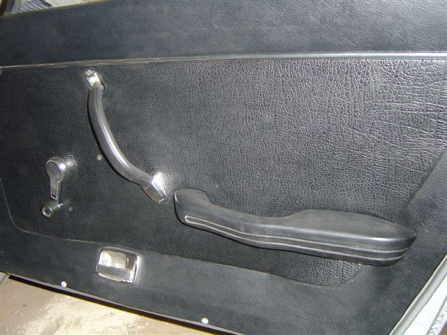

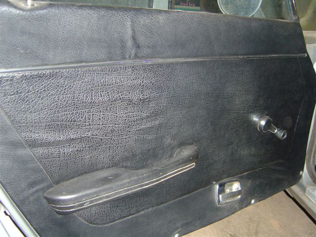

10/70 - #11730 Just recently dismantled the car and believe these parts are original to it. There is no evidence of ever being changed out. The door panels have been sent out already but did not have any screws attaching them.
