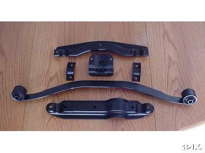

I think he's talking about the curved piece that wraps around the back of the diff. On early 240Zs this piece was straight, and would not clear an R200.
(part at the top of the attached picture)
That would be called the mustache bar.

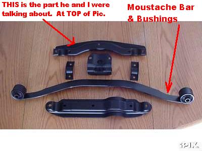

Part at the top of the pic is not the mustache bar.
He will need the 280Z mustache bar AND the part I mentioned which is more of a "curved cross member" if his car doesn't already have one..
See THIS attachment
See THIS attachment
Thank you for the correction, I did not even think about that cross memeber.
