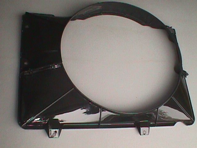

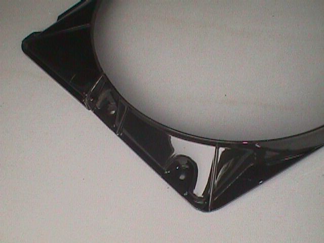

Here are a couple of pics of the shroud I restored for my '71. After I received the 4-row rad, I realized it would not fit. I bought another one but it did not have the bottom piece with it. I still think I need one for summer traffic.
WOW! Mine aren't that shiney, but I do have that style.
How did you make that thing look so wet?
A buddy of mine is a auto painter. Whenever he is doing a clear coat, I always take a few things in for a couple of coats. He did my fuel tank, my lower engine shield and my brake booster. Makes them look like new!
ZSaint's shroud has the same bolt hole spacing as my radiator, so we got a match. Still wondering why the 2 piece shroud I bought a few years ago wouldn't fit--the hole spacing was about 3" longer in each direction than my radiator. Could this shroud be for a 260Z?
