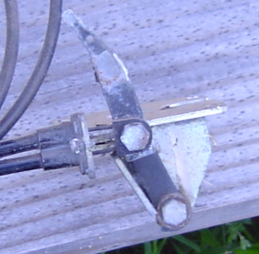

The first of Mat's pictures is the 70-71 style. I found that if the lever mechanism on the console is good, you can replace the cable itself (which is a single looped cable) with the longer one from a later assembly. Shorten them up a bit and they work fine.
