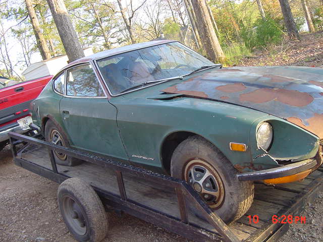

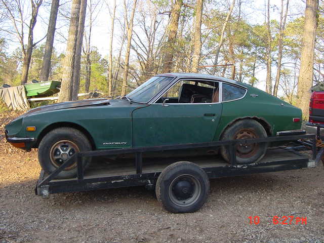

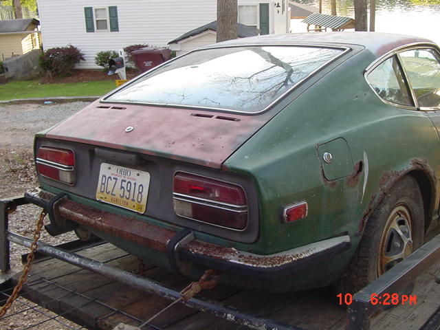

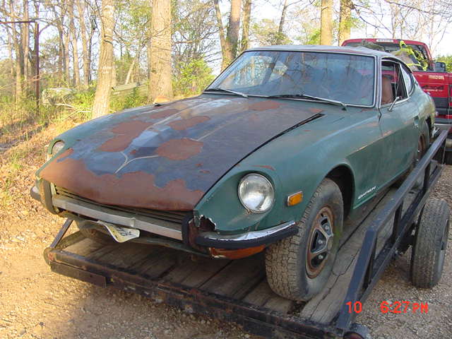

Posted April 17, 200618 yr comment_163928 Okay guys I really need some expert help on my big project.I started out by buying a finished 70 model Z. That turned out to be not as much fun because it didn't need anything so I made up stuff to do to it.Then I bought another 70 model that needed a lot of work.Great,Now I needed parts for it so I bought another Z. It was better than the parts car so I was going to fix up both of them.Now I need another parts car.After several more cars I purchased 000913. I now have more cars than I can use but that don't mean I don't like all of them.My problem now is I wan't to completely restore 913.I have read as many threads and post as I could find and I find so many different ways to restore a z but no two are the same.I realize it depends on the shape of the car and how much time and money you are willing to spend on it.I am retired and time is of no issue.Basically money is not a major factor but I don't want to spend needlessly.Between the extra cars and all the extra parts that came with it I think it will cut down on cost considerably.What I need is some direction to go in to get started.I know there are a lot of you guys that have gone this route before and have great knowledge to share.I am not looking for anybody to hold my hand but to set me in the right direction by recomending books,cds,pictures,or any other information on the subject.I will post pics on the project as it moves along so if anyone sees something needing changing please let me know. Thanks Ronnie Link to comment https://www.classiczcars.com/forums/topic/19674-where-to-start/ Share on other sites More sharing options...

April 17, 200618 yr comment_163934 Considering the visible cancer I see on 913, I'd start by stripping it to the bare shell and getting the shell de-rusted, repaired and painted first. Then you can replace, rebuild or refurbish all the parts as necessary during the slow re-assembly process. Since you have several series 1 cars you have both models to compare to and cars to pull rare parts from as you go. Link to comment https://www.classiczcars.com/forums/topic/19674-where-to-start/#findComment-163934 Share on other sites More sharing options...
April 17, 200618 yr comment_163953 I'd have to agree with Arne. Because of the amount of rust I'd definitely see what all the body was going to require before I did anything. At the same time I'd inventory what could be salvaged from HLS30-00913 and determine what need to be purchased or acquired through a donor. Link to comment https://www.classiczcars.com/forums/topic/19674-where-to-start/#findComment-163953 Share on other sites More sharing options...
