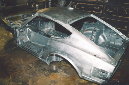

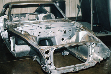

May 20, 200618 yr comment_168118 26th was dipped and de-rusted by electrolysis. The initial dip that took off all the paint was pressure washed clean before the elctrolysis dip that took off all the rust. Keep in mind that the original sheet metal inside the frame rails etc. was never painted and protected to begin with. All this worry about protecting the inside metal from corrosion is overblown. One of the main reasons these cars rust so badly is because they were never protected or sealed properly. My suggestion is to spray the inside metal with self-etching primer. I used a thinned solution in a pump-up garden sprayer - the kind that has the long plastic wand and spray nozzle. Self-etching primer because there is no way to clean and prepare the metal you can't reach, let alone see. In my case, the thin primer solution dripped out the bottom of open seams and made a big mess. Most of the threads I read about sand or media blasting come from people trying to find a cheap, easy, less time consuming way to solve an inside rusting problem by attacking the outside. Painters don't like sand blasting because silica is embedded in the metal and without proper cleaning, paint doesn't stick. The bottom line is that there is no cheap easy way to get rid of the rust. Proper preparation of the body metal involves a lot of time and it ain't cheap. Link to comment https://www.classiczcars.com/forums/topic/19730-sandblasting-concerns/?&page=2#findComment-168118 Share on other sites More sharing options...
