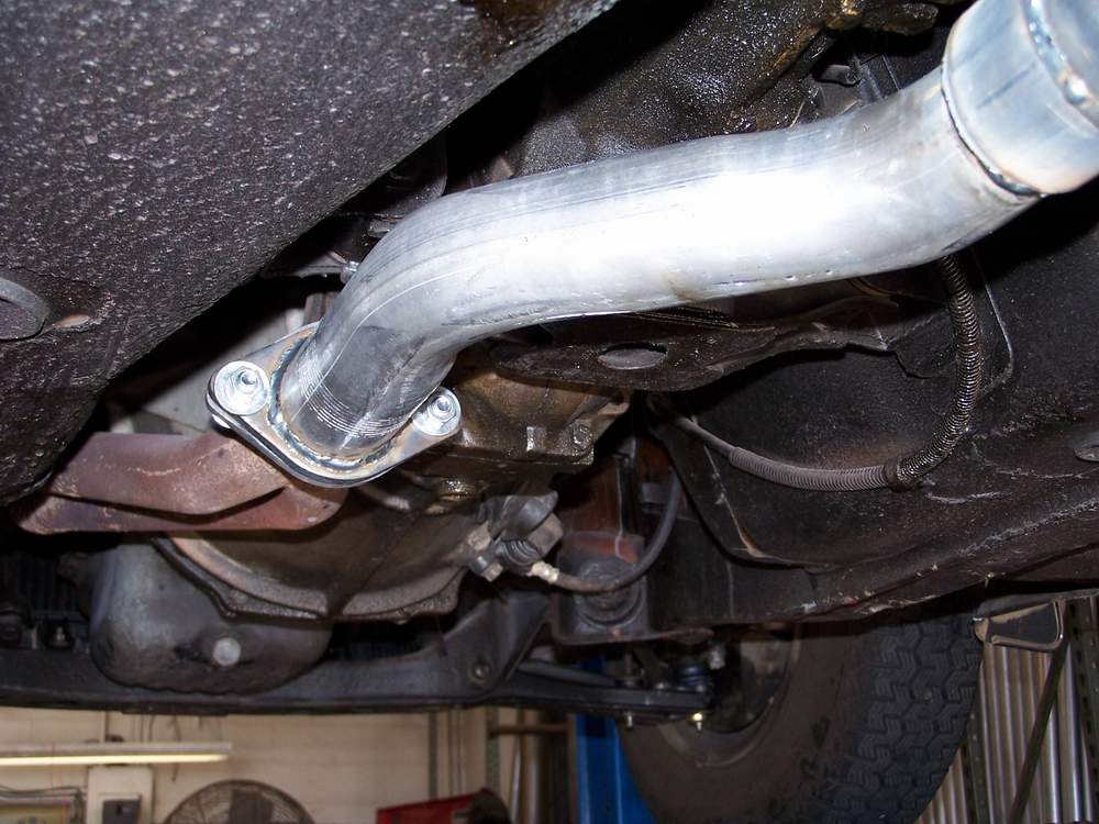

June 9, 200618 yr comment_170534 FWIW, I had a new exhaust system built locally for my 73 stock Z. I used 2- 1/4" aluminized pipe and a Dynomax ROUND super turbo muffler part#17 741. It looks almost like the stock muffler(dimensions:14"X6"...19" total). When I first had the system done I had them put in a 20" glasspac(reversed for better flow) for resonance, but had it removed as the system was too quiet,almost like stock. It sounds much better now, but is not at all loud...just right for me and no resonance. I also had them weld in a flange up front so the system could be removed for suspension work, etc. I'm very happy with the system. It cost about $200 and is nicely tucked up underneath the car...in the same plce as the old system. Cheers, Mike Link to comment https://www.classiczcars.com/forums/topic/19900-the-sound-of-mufflers-dynomax/#findComment-170534 Share on other sites More sharing options...
