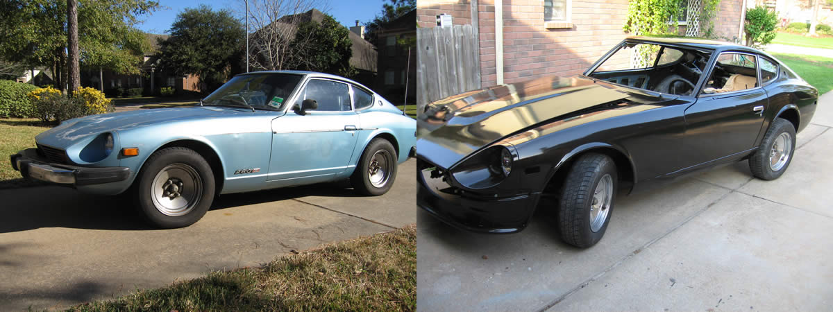

Well paint is finnished!!! Still gotta find a LHS doorjamb as mine rusted out. Then gotta get that welded in. All lights/bumpers and trims are back on. Sanding this w/e(fine wet/fry). Then glass put back in early next week.
Should be back on the roads very soon!!!
