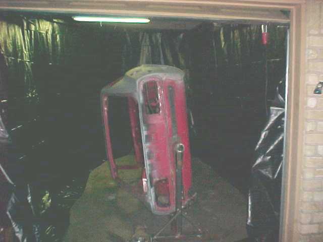

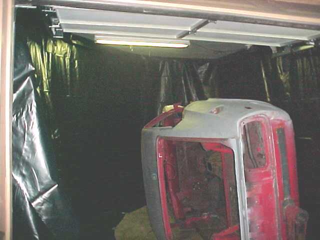

May 5, 200618 yr comment_166324 If you have been convinced to avoid sand blasting, then disregard this post. I sand blasted my entire car in my garage with a portable baster unit from Northern Tools. (Not sure of the cost as I borrowed it from my Dad) The trick with blasting is to get a good media for use on the area you want to treat. Since you are talking about the engine bay and primer that is already coming loose, I would use regular play sand. The fine grain stuff you can get at Home Depot or such. I say this because 1) the sheet metal in the engine bay pretty structurally sound and a little thicker (it has to tie the lower frame rails into the upper frame members along w/ the radiator support), 2) the primer is already coming loose, & 3) play sand is pretty cheap compared to glass bead, walnut shells, etc., that way you don't have to worry about not picking all of it up. The rest of the process involves making an area that you can blast in w/o making a BIG mess, and protecting yourself from the media. I went to Home Depot (sorry for the plug, my bro-n-law works there) and bought a roll of black foundation plastic. This is a 6 mil thickness plastic. Pretty heavy-duty. It comes in a 20' w x 150' roll. (You can sometimes strike a deal w/ concrete guys building a house to get some of this also) Cut it into 10' wide strips about 30-40' long. Starting on one side of one of your roll-up garage doors, staple the plastic to the ceiling moving toward the back of the garage, across the back, and then toward the front on the opposite side of the same door. Then duct tape the bottom of the plastic to the floor. You have now sealed off the rest of your garage from the blasting area. You'll need a dust mask (at a minimum) and some good goggles that will seal to your face (or a hood face shield). Put the car in and get busy. It's not hard and it can go pretty quick. Plus, you won't run the risk of chemical burns on your hands/skin or splatter that will burn scars on your eyes as with paint stripper. (Ever seen what happens when your spray water on an irregular surface with acid coating the metal? It sometimes sprays right back at you!) Link to comment https://www.classiczcars.com/forums/topic/19924-sandblasting/#findComment-166324 Share on other sites More sharing options...

May 5, 200618 yr comment_166326 I think kmack has some good advice.Random thoughts.If blasting think everything/results out. One issue is the removal of sand from hidden areas, cracks and crevices. It will be everywhere, including your A%^.You can make a "booth" for blasting by using metal tubing from electrical conduit. Not too expensive. Hange from ceiling and other places making a box around the car, then hang the plastic mentioned by kmack. Cover the top of this w/plastic as well. This allows you to retain storage, etc. around the perimeter of the space. You have a lot of control over the effect of the media by how close you hold the "gun" from the work.The "finish" of the metal will be anthing but smooth, and require a good fill paint to cover that.Any method of removing paint is "messy" stripper, media, sanding, lots of work.The media blasting insures a clean down to bare metal where as stripping leaves rust if it is there, as does sanding.If you are just trying to get a clean smooth surface to begin painting on, and the original paint is sound, then it would seem that sanding off the top layer of "junk" paint would be your best solution. The original primer and a layer of finish paint is good for a base as long as you use a good sealer that adheres to start the finished job.Good luck Link to comment https://www.classiczcars.com/forums/topic/19924-sandblasting/#findComment-166326 Share on other sites More sharing options...
