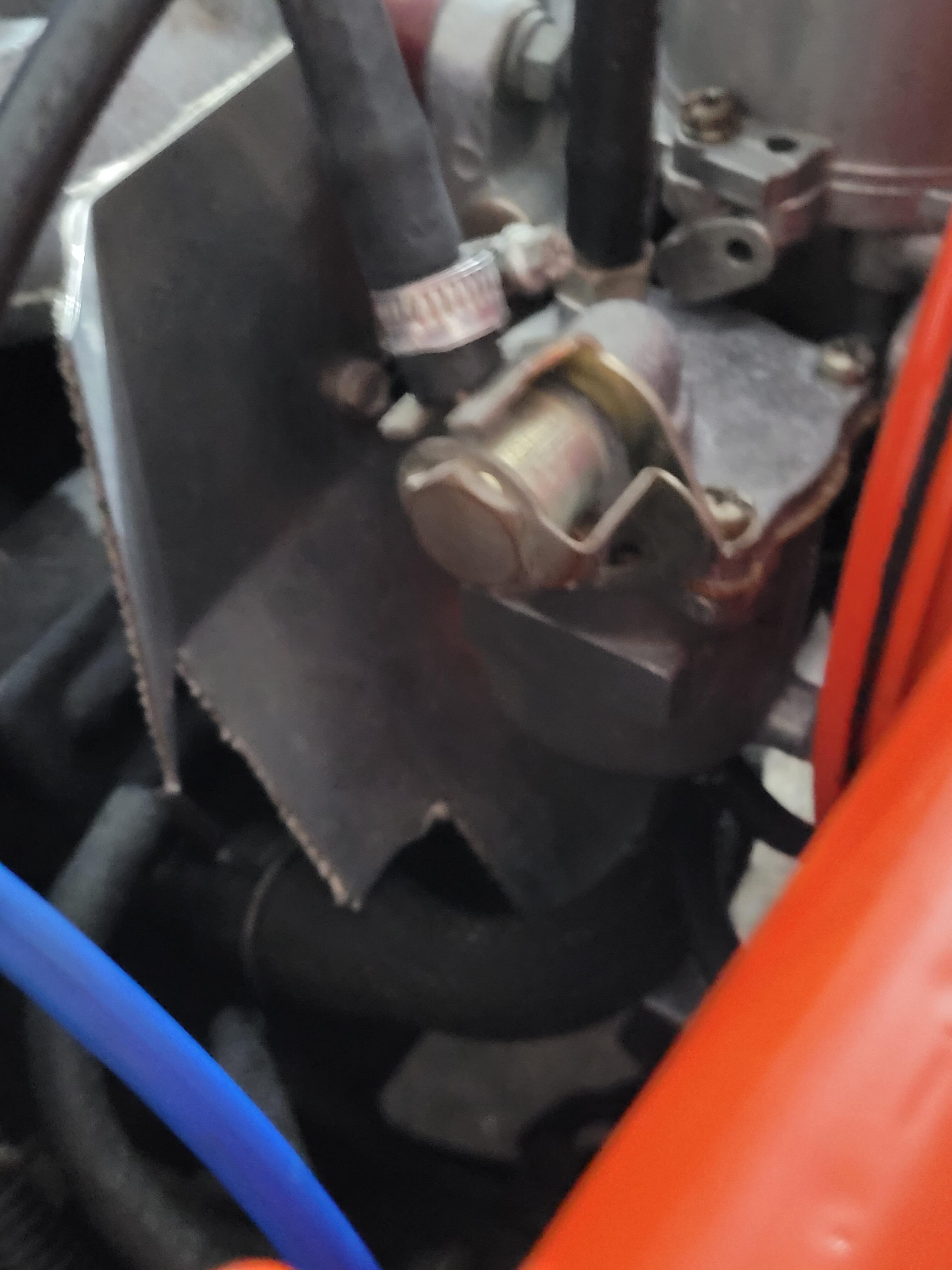

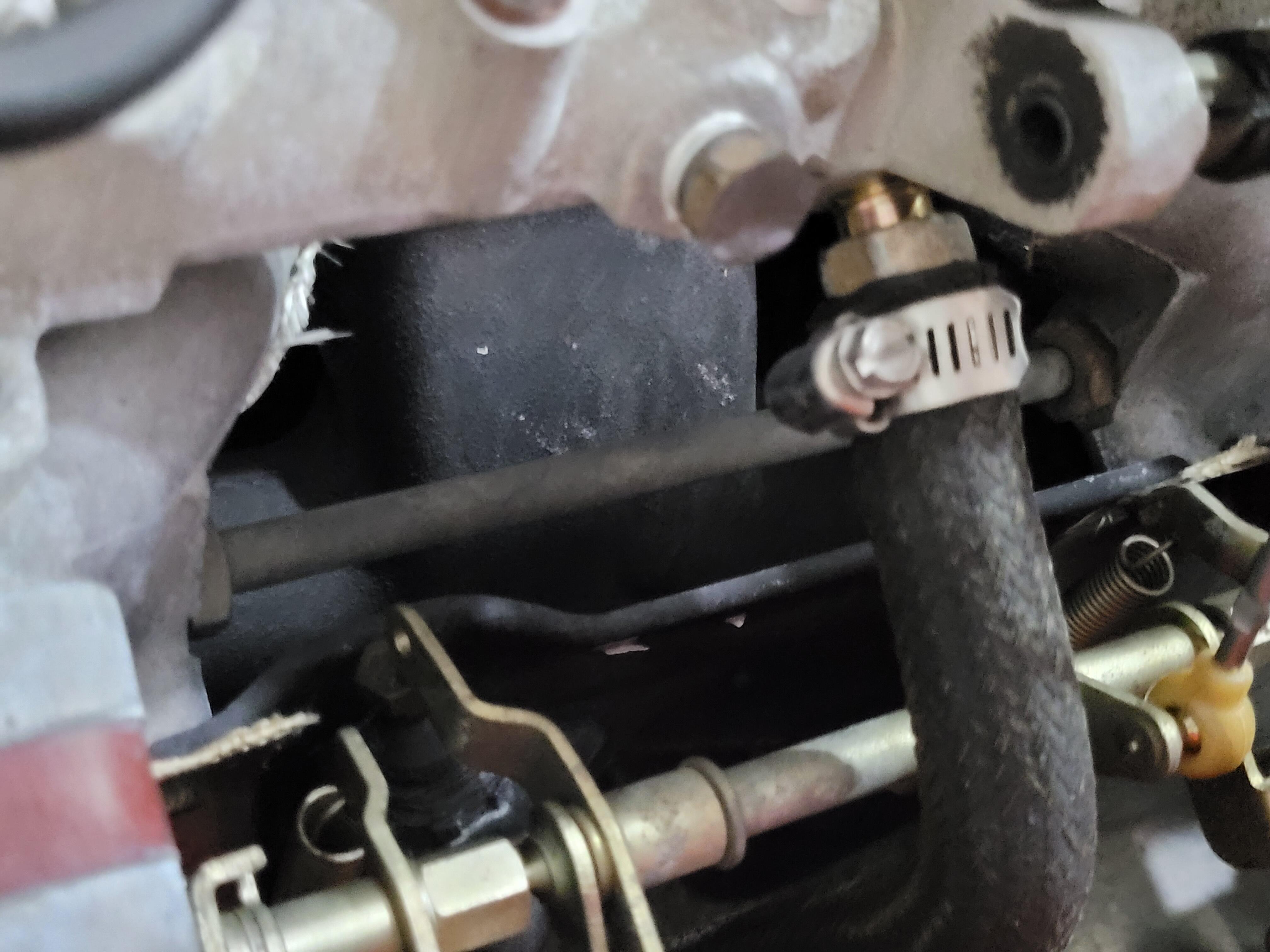

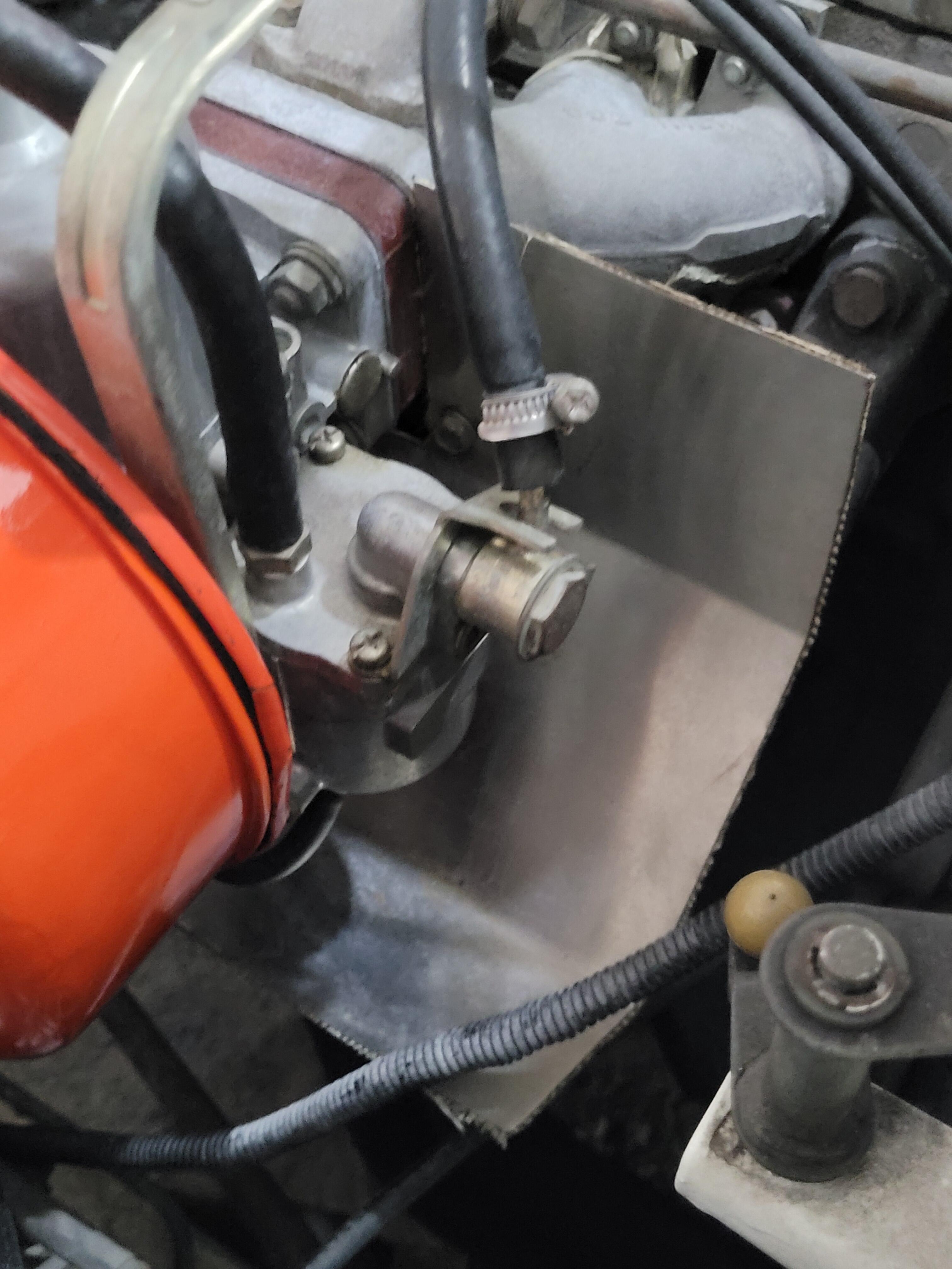

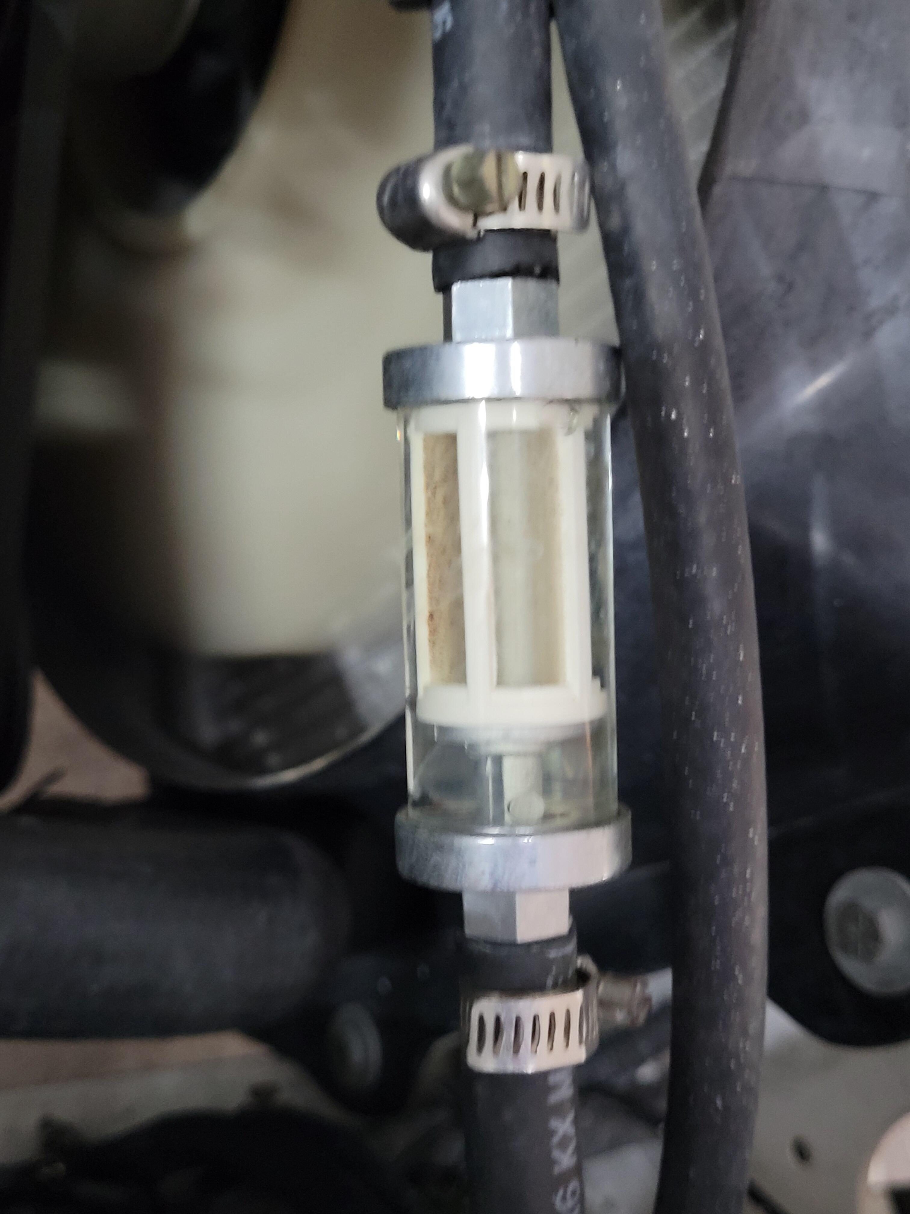

Yes i will find out about this. My engine block is E88. I also took some pictures where you can have a glimpse of the heat shield, phenolic spacers and heat shield extension for your reference. No bubbles at the fuel filter.20220110_115044.jpg20220110_115322.jpg20220110_115044.jpg20220110_115213.jpg20220110_115044.jpg20220110_115349.jpg

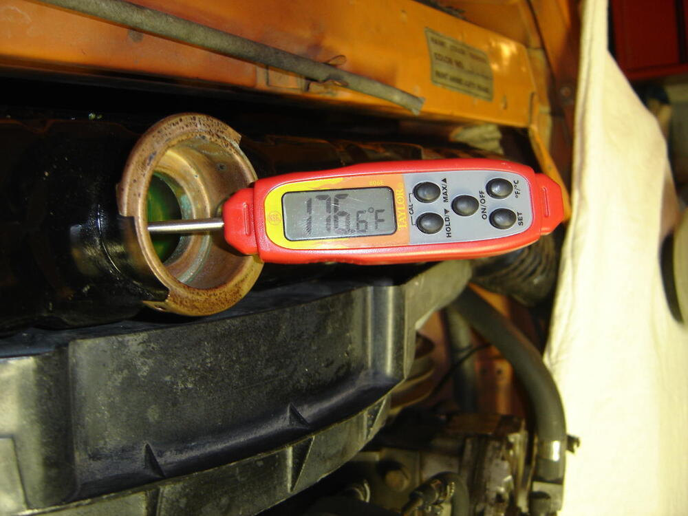

A. What's the temperature in Panama? (closer to Phoenix, Arizona temperature or Northern Utah temperature?)
B. What's your WATER TEMPERATURE when you're sitting in traffic? (Is your problem with engine cooling OR heat soak in the carbs?)
I said what mine was sitting still in my garage, no air flow except the OE fan. I'm not sure he ever tried that but that would be the same as stand still traffic. This was 3 years ago...
