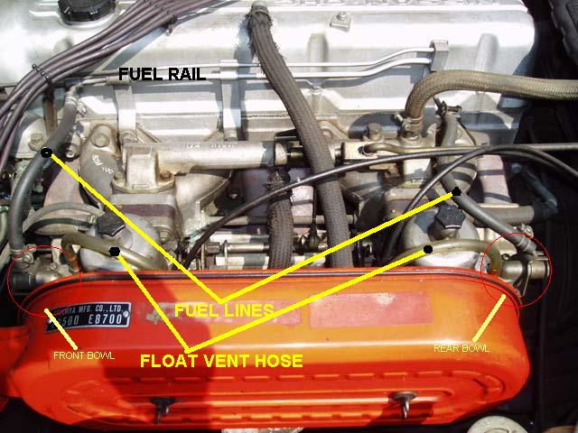

Thanks for the replies. My car is a hundred per cent standard euro version, which runs the Hitachi carbs. I don't know if they are flat top or round top, can't tell them apart :stupid: Anyway, it has a P30 block, E88 head, and has E41 stamped somewhere on the intake manifold. Dunno what kind of fuel pump does it have, but I suppose it's the original one. I got some original Dat parts with the car, so I don't think the last owner played in adapting parts from various other cars. Here's a picture for reference:
The air filter cover isn't as bright as it looks in the picture, I accidentally used the camera flash... Anyway, I tried again today, and the same problem occured. After a while it ran well, just as yesterday. It seems that I'll have to take it to a mechanic earlier than I thought...

You definately have the round top carbs. As shown in your picture, the front of the car to the left, look at your carbs. To the left of the left carb is the float bowl. It will have two hoses on top, one to the fuel rail and one to the air cleaner. Underneath, it will have a small hose going to the underside of the carb to the needle/seat assembly.
On a cold engine remove the three hoses, remove the 10mm nut holding the bowl to the carb. Take your bowl to a clean work area and begin to disassemble. Clean everything and reset your float level. If you have a shop manual it will become very handy. Use plenty of carb cleaner. Once you clean both bowls and have the floats set let us know how she runs.
