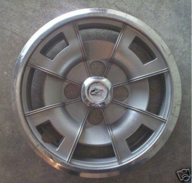

Not sure what you mean by the "honeycomb" hubcaps.

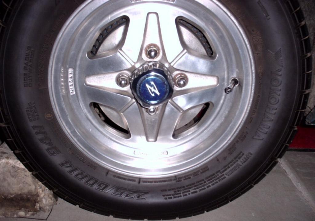

I believe he's referring to these. The second picture is the factory alloy option from 74-78. Some people refer to these as the 'Black Pearl Wheels' but they were an option for any 260z or 280z.
I've always liked the look of both those wheels.
The first set is what I referred to as the "Maltese Cross", but not because of that being their name, but rather because that's what I recall someone naming them. It may have been here or in another discussion group.
The second set looks really nice if in a gold tone finish on the "rough" cast, leaving the smooth in silver.
I'm wondering if he's referring to a set of WHEELS that had the "honeycomb" hexagon on the radius out from the lugnuts central core to the actual rim.

sblake, thanks for posting the pictures. What I have is what's in picture number one, the hubcap.

EScanlon & sblake, I've considered buying a set of the OE wheels but all that I've seen are too expensive. I have the hubcaps re-finished and ready to go and I really like the way they look. I'll always try to return the car to stock/OE unless price gets in the way.
