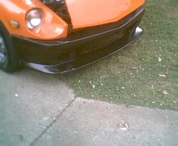

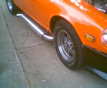

July 3, 200618 yr comment_173180 on the stock 14 in rims run 235 60 14ther wide enough looks wise but dont scrub and that is tha i have a custom front bumber and i can clear it also Link to comment https://www.classiczcars.com/forums/topic/20147-tire-size-issues/#findComment-173180 Share on other sites More sharing options...

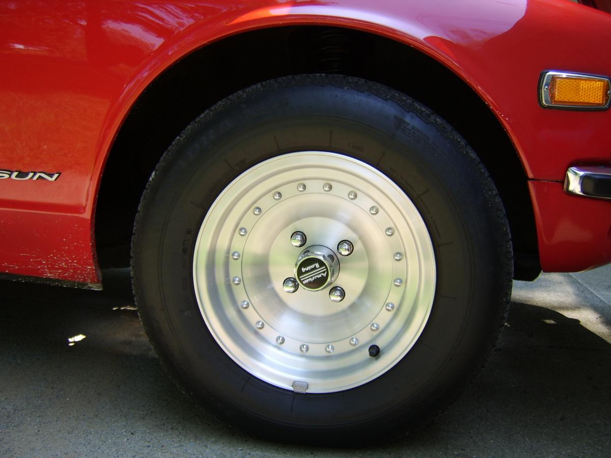

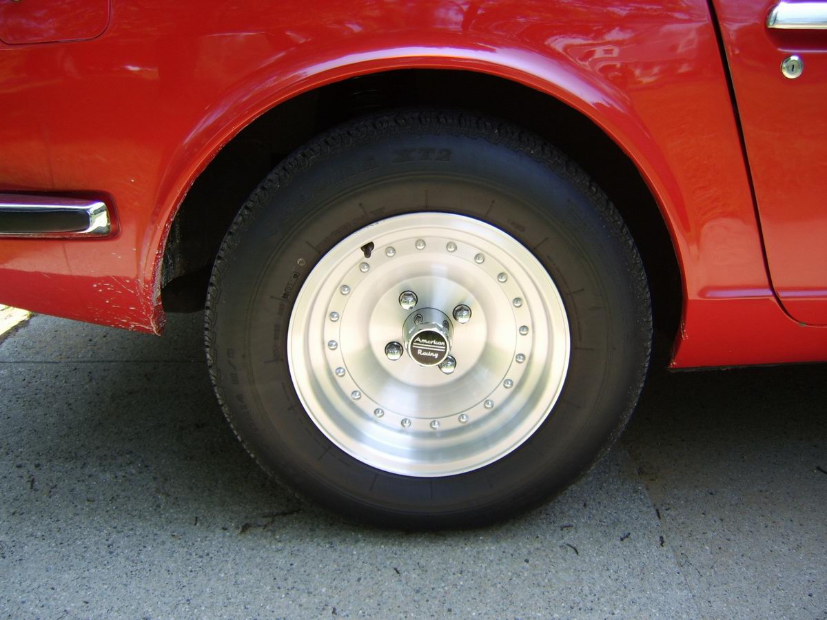

July 3, 200618 yr comment_173241 I have 205/70r14 with stock height springs installed this month on my 71Z. Link to comment https://www.classiczcars.com/forums/topic/20147-tire-size-issues/#findComment-173241 Share on other sites More sharing options...
