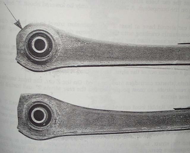

The following is from the “Jags That Run”V8 conversion manual:
Remove the front cross-member, remove the doublers that are spot welded to the
cross-member. Weld .060” thick steel doublers inside the cross-member, drill
14mm (9/16”) holes ¾” (center to center) above the original holes (and ¼” outward
if you want o add negative camber). Weld the original holes shut, grind flush and
re-paint. The upper inboard corners of the lower control arms will have to be grinded
to prevent them from contacting the cross-member.

Sorry, I don't have a scanner, but this link that mperdue posted covers it pretty good.
http://240z.jeromio.com/frontcross.html

Sorry, I haven't done it yet, I'm just passing on what I've read. I'm not to that point in my restoration / modification yet.
