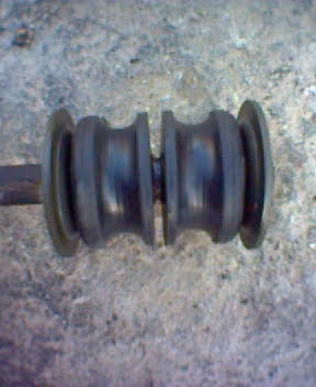

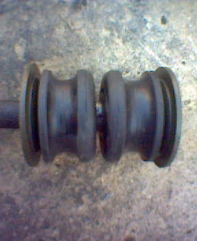

I baught new bushings and washers for my 280Z from VB, but the joke is that I dont know how to install them after I had a small discussion with one of my friends which claimed that it must be arranged as the second way show on "pic2",
I thaught that it must be the same as in the "pic1", so I decided to ask about it here coz I really trust u guys more that anybody out there!:beard:
another thing, the washers must bu fitted as in the pictures or the opposite way? I mean like this -----(--) or like this ------)--(??
and the washers can be exactly the same? since I had a very slight difference on the nut's side..
I appreciate an accurate simpele answer.. thanx..
I would say go with pic 2. Thats how I installed mine, with the big radius facing outward, but mine were urethane and they didnt look the same as yours. Here's a link that might help you out.

DArrel, Dtsnlvrs, thanx for the confirmation, and I guess that I fitted the washers correctly from your reply,
Dtsnlvrs, the sleeve is there, but is it ok if it has a shorter length as the bushings togeather?
and while tightening, I should tighten untill it becomes hard? coz I think that the sleeve must be free to travel.. in this case I guess I'll need a tourque wrench so both sides will have same flexibility..correct?
The sleeve is there to prevent over tightening and to set the caster. Just tighten the nut until a sharp rise in torque is felt. That means you have bottomed onto the sleeve and cannot go any further....that is the easiest way to set them.
