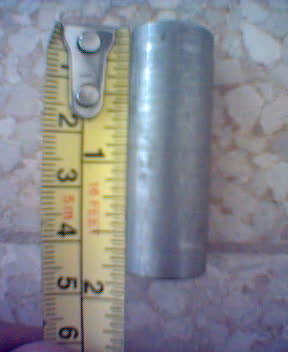

June 2, 200618 yr Author comment_169705 u ganna have a nice ride after u replace them I hope:)Palmer, if your parts are still out of the car, can u please measure the length of the sleeve taht u have in mm plezzzzz?:knockedou Link to comment https://www.classiczcars.com/forums/topic/20260-compression-rod-bushing-arrangment/?&page=2#findComment-169705 Share on other sites More sharing options...
June 3, 200618 yr comment_169817 Bu:The sleeve is exactly 2 inches long.... Link to comment https://www.classiczcars.com/forums/topic/20260-compression-rod-bushing-arrangment/?&page=2#findComment-169817 Share on other sites More sharing options...
June 3, 200618 yr Author comment_169827 2 inches!!:dead: that is 50.8mm!oh $^!#, I found out that one side's sleeve has 46mm and on the other side is 33mm!I would kill the pre-owner of my car!I felt something wrong when I sat the sleeve hiding much inside the bushing!that explains it..Palmer, thanks a lot.. Link to comment https://www.classiczcars.com/forums/topic/20260-compression-rod-bushing-arrangment/?&page=2#findComment-169827 Share on other sites More sharing options...

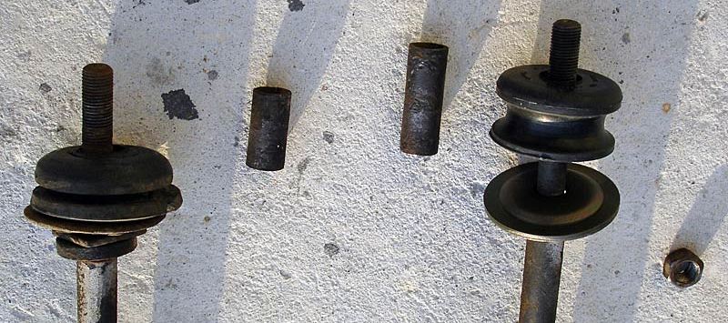

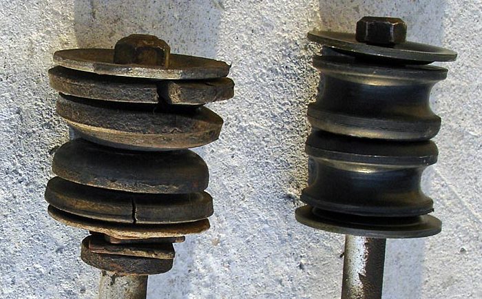

June 4, 200618 yr Author comment_169908 in the attached pictures is my left hand comp. rod with the new bushing on the right and the right hand comp. rod with the old bushing on the left, look how did that sinner make the assembly! on pic2 the sleeves that have 46mm and 33mm which I assume wrong for both refering to Palmer's post about the length being 2 inches=>51mm! pic3 shows the sleeve with one bushing rubber and see how short it is! it'll hide if I insert the second one almost at the middle of it! so what do u think of those people guys! Link to comment https://www.classiczcars.com/forums/topic/20260-compression-rod-bushing-arrangment/?&page=2#findComment-169908 Share on other sites More sharing options...
June 5, 200618 yr Author comment_170014 oh Palmer, this is a new sleeve that the dealer claimed that all datsuns have, it is "about" 2" long.. is it the same length you were mentioning by "exactly 2 inches"?? will it make a big problem to have it like this if it is shorter? Link to comment https://www.classiczcars.com/forums/topic/20260-compression-rod-bushing-arrangment/?&page=2#findComment-170014 Share on other sites More sharing options...

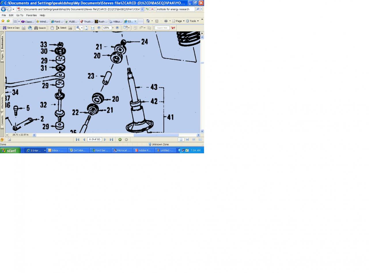

August 9, 200816 yr comment_255908 The Nissan parts catalog shows them installed with the thick side of the bushing towards the frame mount. Link to comment https://www.classiczcars.com/forums/topic/20260-compression-rod-bushing-arrangment/?&page=2#findComment-255908 Share on other sites More sharing options...
August 9, 200816 yr comment_255909 An therein lies the controversy.....I'll trust a perfect fit over a lousy picture anyday. Edited August 9, 200816 yr by =Enigma= Link to comment https://www.classiczcars.com/forums/topic/20260-compression-rod-bushing-arrangment/?&page=2#findComment-255909 Share on other sites More sharing options...
August 9, 200816 yr comment_255911 I just changed mine, the old ones were installed as per the parts catalog. The new ones went in the same way, and fit perfectly. Its also logical that they would be installed that way. The load on the bushing is going to be from the body, not from the washer, therefore the heaviest portion of the bushing would go towards the body. Edited August 9, 200816 yr by whamo Link to comment https://www.classiczcars.com/forums/topic/20260-compression-rod-bushing-arrangment/?&page=2#findComment-255911 Share on other sites More sharing options...
