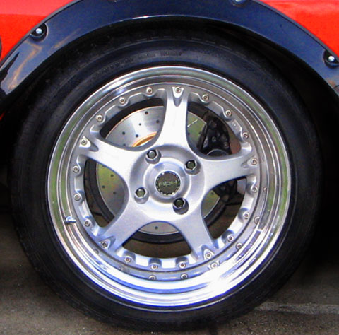

Posted June 12, 200618 yr comment_170757 Well I finally found some time to install new bearings and rotors. After spending much time thinking about upgrades I settled for solid slotted and cross drilled rotors. Some considered options were changing calipers to someting like Z32 calipers but thought it to be too much work at the moment. The wieght issues of the 4x4 Hilux brakes concerned me. Vented discs would be nice but since it's not a track car probably not that beneficial. So I decided I wanted something that would improve my stopping power when needed occasioanlly and look nice through the wheels. The DBA rotors I got do this and look good I reckon. Pics attached. They costed me AUD$320.00. Still gotta do the rear upgrade! Cheers Sulio Link to comment https://www.classiczcars.com/forums/topic/20389-new-slotted-cross-drilled-rotors-installed/ Share on other sites More sharing options...
June 12, 200618 yr comment_170758 Nice, what diameter is the new rotor? Is that a stock 2-pot I see there?What are you running at rear atm? Link to comment https://www.classiczcars.com/forums/topic/20389-new-slotted-cross-drilled-rotors-installed/#findComment-170758 Share on other sites More sharing options...
June 12, 200618 yr Author comment_170763 Stock calipers with stock size rotors. Rear is still stock, hoping to upgrade to R30/31 sjyline rears when I get a spare weekend. Link to comment https://www.classiczcars.com/forums/topic/20389-new-slotted-cross-drilled-rotors-installed/#findComment-170763 Share on other sites More sharing options...

June 20, 200618 yr comment_171679 I'd still deffinately go the hilux calipers - there isn't much difference in weight and the stopping power difference is huge ! Link to comment https://www.classiczcars.com/forums/topic/20389-new-slotted-cross-drilled-rotors-installed/#findComment-171679 Share on other sites More sharing options...
June 21, 200618 yr Author comment_171787 Yer I still might go down that track. Has anybody got a weight difference on stock calipers and the 4x4 calipers? Link to comment https://www.classiczcars.com/forums/topic/20389-new-slotted-cross-drilled-rotors-installed/#findComment-171787 Share on other sites More sharing options...
June 21, 200618 yr comment_171788 when i swapped mine over i made a little in hand comparison and there was bugger all difference - not enough to warrant not having them!! Link to comment https://www.classiczcars.com/forums/topic/20389-new-slotted-cross-drilled-rotors-installed/#findComment-171788 Share on other sites More sharing options...
June 22, 200618 yr Author comment_171920 Oh if thats the case I'll get em. Seeing it's such a cheap and easy conversion!Thanks Link to comment https://www.classiczcars.com/forums/topic/20389-new-slotted-cross-drilled-rotors-installed/#findComment-171920 Share on other sites More sharing options...
