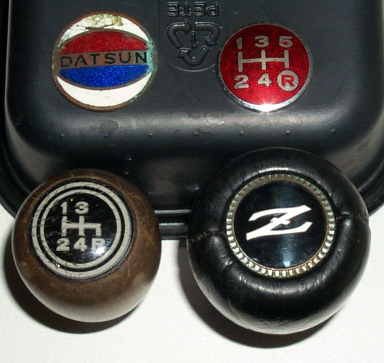

November 14, 200618 yr comment_189597 While I look for mine, someone post a pic of theirs, maybe I have it wrong-I've never bought a shift knob from th dealer, and it could well be that all I have seen is aftermarket versions...Will Link to comment https://www.classiczcars.com/forums/topic/20489-restoring-origional-shift-knob/?&page=3#findComment-189597 Share on other sites More sharing options...

November 15, 200618 yr comment_189644 I have a copy of a Datsun asccessory brochure for the 1972 240Z. As options, Datsun offered two different shift knobs with the "colorful Datsun logo". One was vinyl-covered part no. 99990-00005, and the other was polished walnut part no. 99990-00004. Hope that sheds some light on whether they were available stock, or not. My 07/72 Z has the optional polished walnut knob with the Datsun logo, as well as the optional dual racing mirror set part no. 99990-0013.RogerA picture would help with your great part number and availability info!Will Link to comment https://www.classiczcars.com/forums/topic/20489-restoring-origional-shift-knob/?&page=3#findComment-189644 Share on other sites More sharing options...
November 15, 200618 yr comment_189648 This pic has four of the emblems I have seen in Zs, If I the 4spd is stock '69-'73, but what I have seen most often in S30s the red 5spd emblem on the wooden knob with the 4spd emblem on it. Will Link to comment https://www.classiczcars.com/forums/topic/20489-restoring-origional-shift-knob/?&page=3#findComment-189648 Share on other sites More sharing options...
