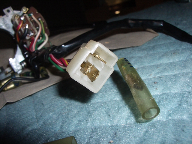

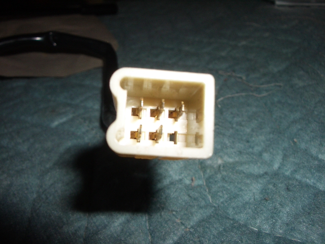

My turn signal switch broke in my 73 240. I am looking at a 71 switch on ebay does any body know if it will fit? Ihere are a few pics.I need help cuase the law man has pulled me over and he gave me a warning to get it fixed. I dont wont to pay any more tickets. Can i wire it up to fit? help me please.

If it is broken, well I have a '70 240 and I installed a different switch. Not sure if it was a '72 or not, but the angle was slightly different (now it sometimes bumps my leg while I am driving). Other than the annoying angle the different switch works fine.

I'm pretty certain that the connectors for the '71 switch are not the same as for the '73. You may be able to get it to work if you re-wire things a little, though.
My 70 is the same as the one Bryan posted. the difference is the wire colors do not match but, the function is the same. The ground wire going from the turn switch to the combo switch is red instead of black.
