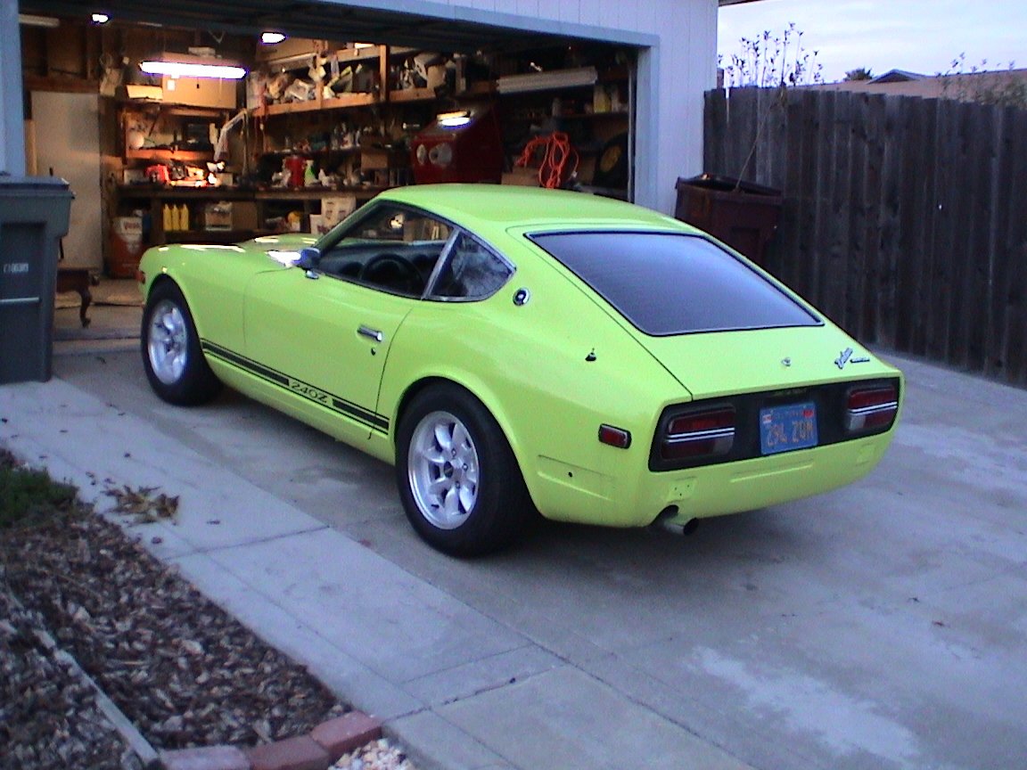

I have ST springs, full PU bushings, and KYB 4-way adjustable strut cartridges.
The car is WAY TOO STIFF for street use. At least, it is if you're 30+ years old. Struts have to be set full stiff in the front and 3/4 in the back to dampen oscillation (horrible in the front especially)
On the other hand, I just took it to the track and kicked major arse, so I guess it's a great compromise. Ride height is, uhh, I dunno, here's a pic.
http://www.sonic.net/~kyle/kylez.html
Before getting bitten by the track bug (and before restoring the car and forgetting how much fun it is to drive) I always planned on swapping the STs out for something else, Euro progressive maybe. Now? I'm happy. Plenty happy. :-D
