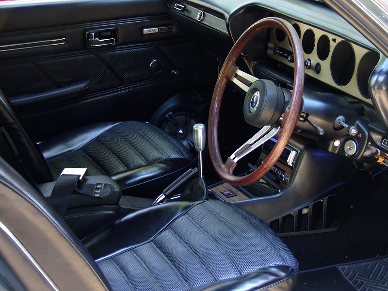

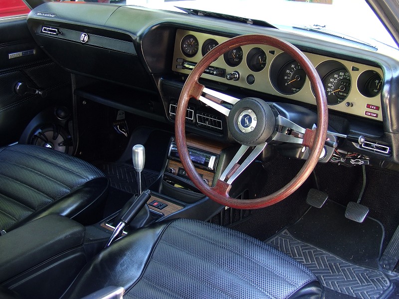

Here are some pics :nervous:

hey, i don't see a nardi, but i do see a new school billet shift knob ...

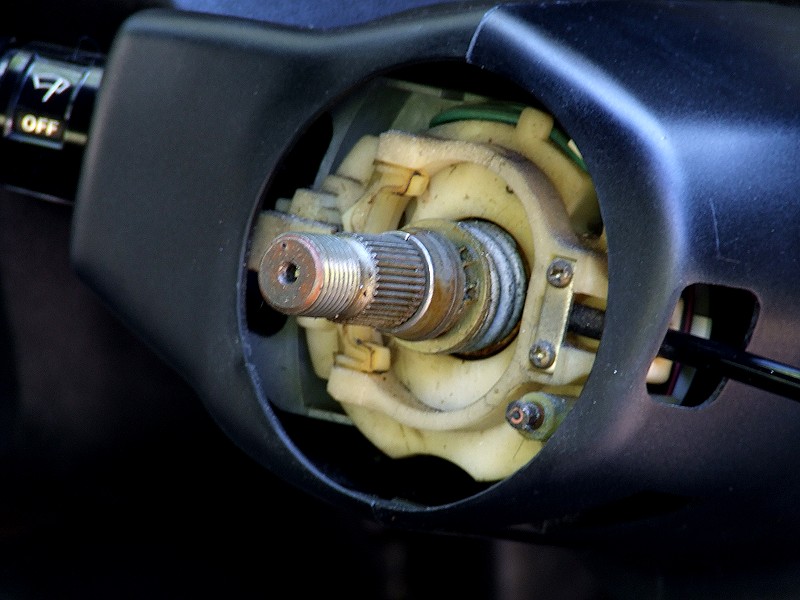

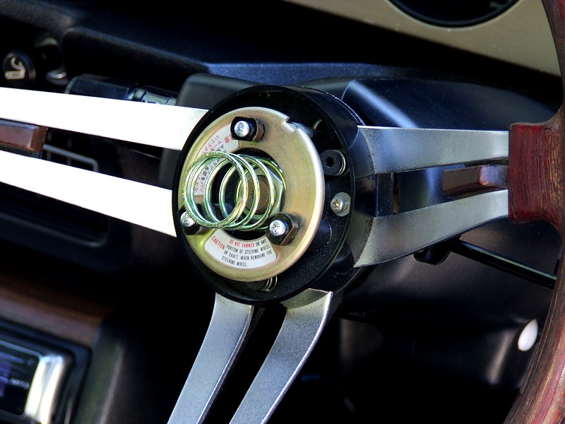

Hey Lachlan, can you take a photo of the hub adaptor kit and the steering wheel's front & back?
is there a sprung contact on 240ks when you take the steering wheel off? maybe its not touching the back of the steering wheel?

oh i didnt notice, yeh thats the one, is that contact touching the hub adaptor or boss kit?
