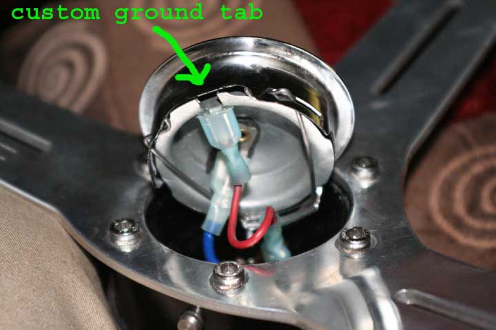

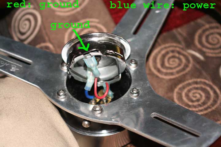

hey lachlan...i read the post kinda fast but jus wondering if you figured out youor horn not working problem....ive played with so many wires on different cars with no horns but managed to get them all working....
if your horn still not working...the nardi horn button might have 1 or 2 spade tabs (1) for ground and the other for power...most of the time the middle tab is power.
what i did on my nardi button, i made a ground tab, look at the pics so you can see the idea what i did, bascially i got a dremel and cut 2 slits and bent it to make a tab so i can plug a spade connector to it. with the ground tab, you can connect it to one of the 6 screws for the steering wheel for ground.
and for the power wire just connect it to the original horn power wire in the harness, if your not sure what wire it is, you can trial and error, grab some wire you think is the horn and ground it, it it honks then you got the right wire. if you still need some help email me at mikeseez@cox.net
mikey
i run a quick release steering wheel hub so the wiring my look different than yours, but all you do it run the ground wire behind 1 of the 6 screws that bolt to the hub to the steering wheel and your ground is done, then hook up that power wire to the single spade behind the horn button and your horn should work, if not email me ill go through it with more detail...
mikey

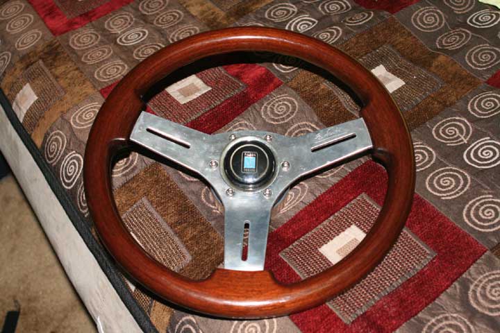

hey all, finally started playing around with the datto again and got the steering wheel all finished up... think i put it on about 5 times before i got it perfectly straight other than that it was all pretty easy.
here's the pic
