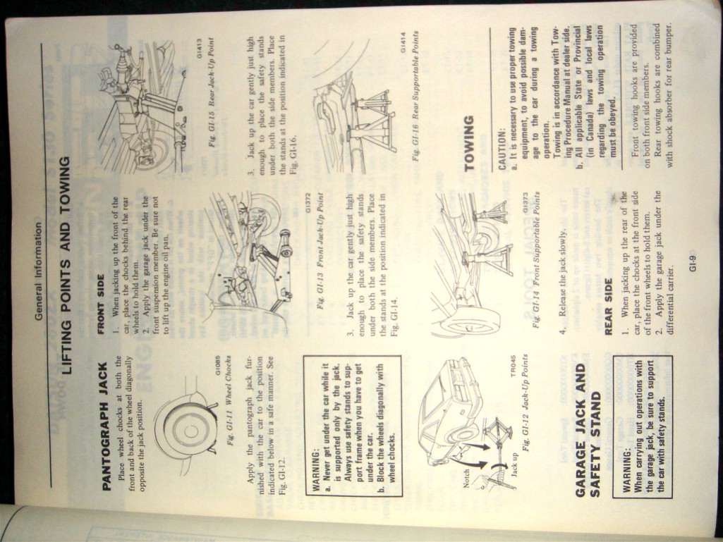

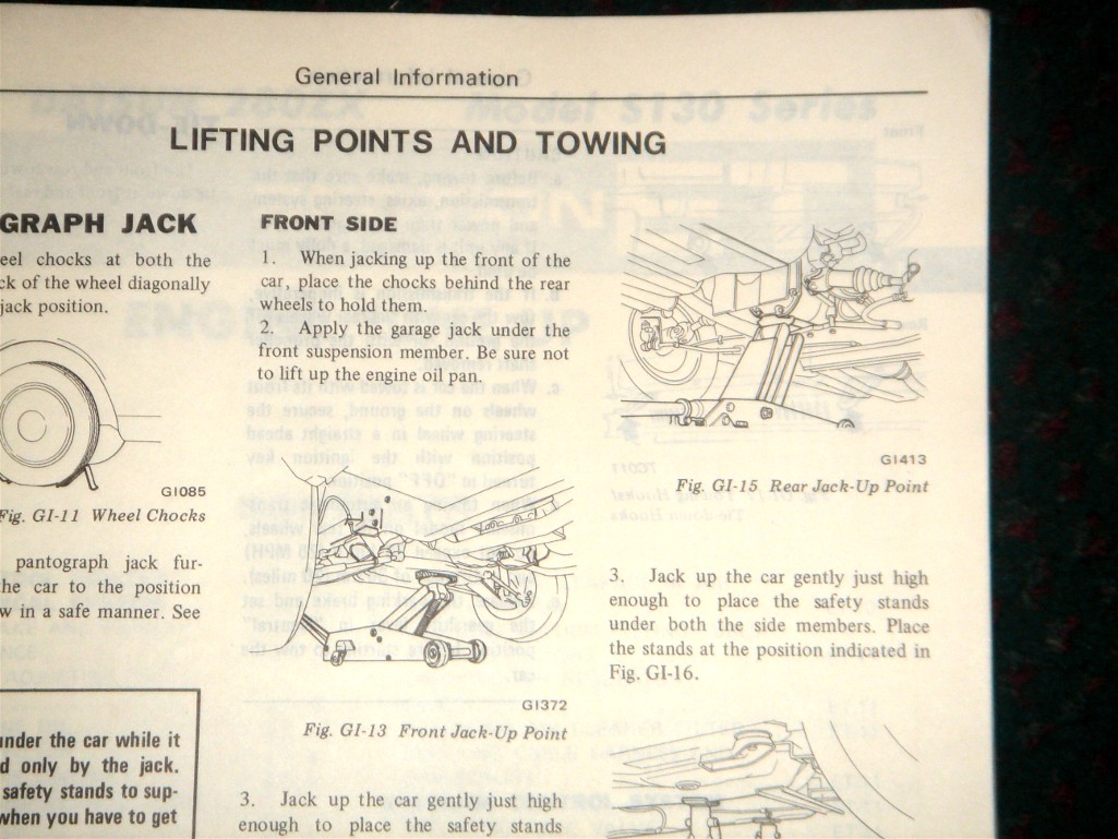

July 1, 200618 yr Author comment_173010 Bah, sounds like this will be quite a chore. Good thing it's only 95 degrees out, and 110 in my garage.I've done some more searching, and I'm trying to find a good spot for my floor jack to lift the rear. I know I can put the jack stands on the frame rails at the back, but I need to know where to put the jack to lift the car in the first place.Some posts mentioned the front differential mount. Anyone have a picture of this location? I don't want to punch thru sheet metal or smush the differential while I'm at it. Link to comment https://www.classiczcars.com/forums/topic/20617-ebrake-releaselove-that-rust/#findComment-173010 Share on other sites More sharing options...
July 1, 200618 yr comment_173019 I'm pretty sure that would be the best place to use a floor jack. Otherwise, do it like you would if you had to change the tire (no fun in the heat of your garage) Link to comment https://www.classiczcars.com/forums/topic/20617-ebrake-releaselove-that-rust/#findComment-173019 Share on other sites More sharing options...
July 1, 200618 yr comment_173022 It seems that the fine folks at Nissan felt that your traditional jack points would work for the z's. Look for where panels meet between the wheels (running board area) as this should be the strongest body jacking location. Link to comment https://www.classiczcars.com/forums/topic/20617-ebrake-releaselove-that-rust/#findComment-173022 Share on other sites More sharing options...
July 1, 200618 yr Author comment_173023 Good old scissors jacks.If I can't find a suitable place for my floor jack, I guess I'll go with the old tried and true. Thanks bane. Link to comment https://www.classiczcars.com/forums/topic/20617-ebrake-releaselove-that-rust/#findComment-173023 Share on other sites More sharing options...
July 2, 200618 yr comment_173030 I hope these will help- Link to comment https://www.classiczcars.com/forums/topic/20617-ebrake-releaselove-that-rust/#findComment-173030 Share on other sites More sharing options...
July 2, 200618 yr Author comment_173041 I actually went out to the garage and had a siesta on the floor, which apparently is the sole supplier for the continential USs spider supply, and located the front differential mount.While fighting off legions of multi-legged attackers, I determined that it will certainly require two people to position the jack properly...one sliding it in from the side, and one watching from the back. The fuel tank prevents the lift handle from raising high enough.I didn't get much of a chance to look around, aside from hunting for the differential mount, but I did notice that the springs on each terminating end of the ebrake cable, where they meet the back of the drum, appear to be somewhat compressed, based on some pictures I've seen of other people's brakes.Of course, things do differ between models and individual vehicles, but at this point it looks as if the brakes have rusted to the drum and are preventing the cable from retracting, and because I had the brake set pretty tightly, I have little doubt that those wheels won't be anxious to spin once they're off the ground.As an aside, is that the 280ZX service manual, or owners' manual? I really do need to get ahold of a service manual. Link to comment https://www.classiczcars.com/forums/topic/20617-ebrake-releaselove-that-rust/#findComment-173041 Share on other sites More sharing options...
July 2, 200618 yr comment_173111 It's the service manual-came with the car! Link to comment https://www.classiczcars.com/forums/topic/20617-ebrake-releaselove-that-rust/#findComment-173111 Share on other sites More sharing options...
