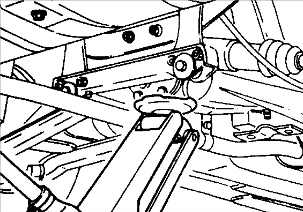

According to the service manuals on both my 1978 280Z and my 1970 240Z, the jack point isn't the front of the differential - it is the case itself. See the attached image. I have jacked my 280Z many times from that point, and it has never failed me yet!
