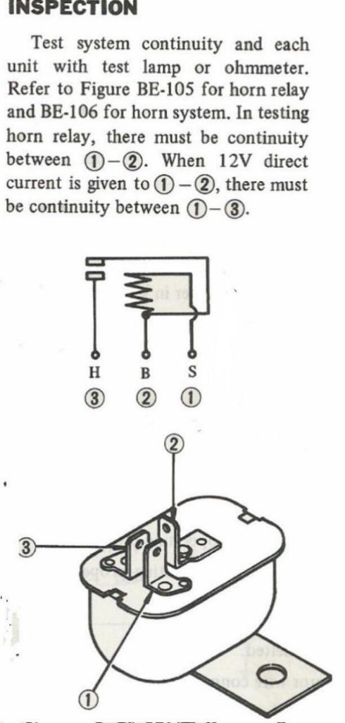

Hrm... so okay then, relay still looks like the prime suspect.
... but I'm confused as to how the relay even got power in the first place? I didn't bump the horn switch at all.
One hand was on the wheel, top left, other hand was on the stick. Horn started going off by itself.
If I have done this right, maybe the photo will show and it will be of some help.

E
TY Zbane, that picture helps spell it out for me a bit more clearly (and thank you Enrique!).
I've also found this pic that helps illustrate what the horn relay looks like... it just doensn't give me a solid pic of where it is! :P
