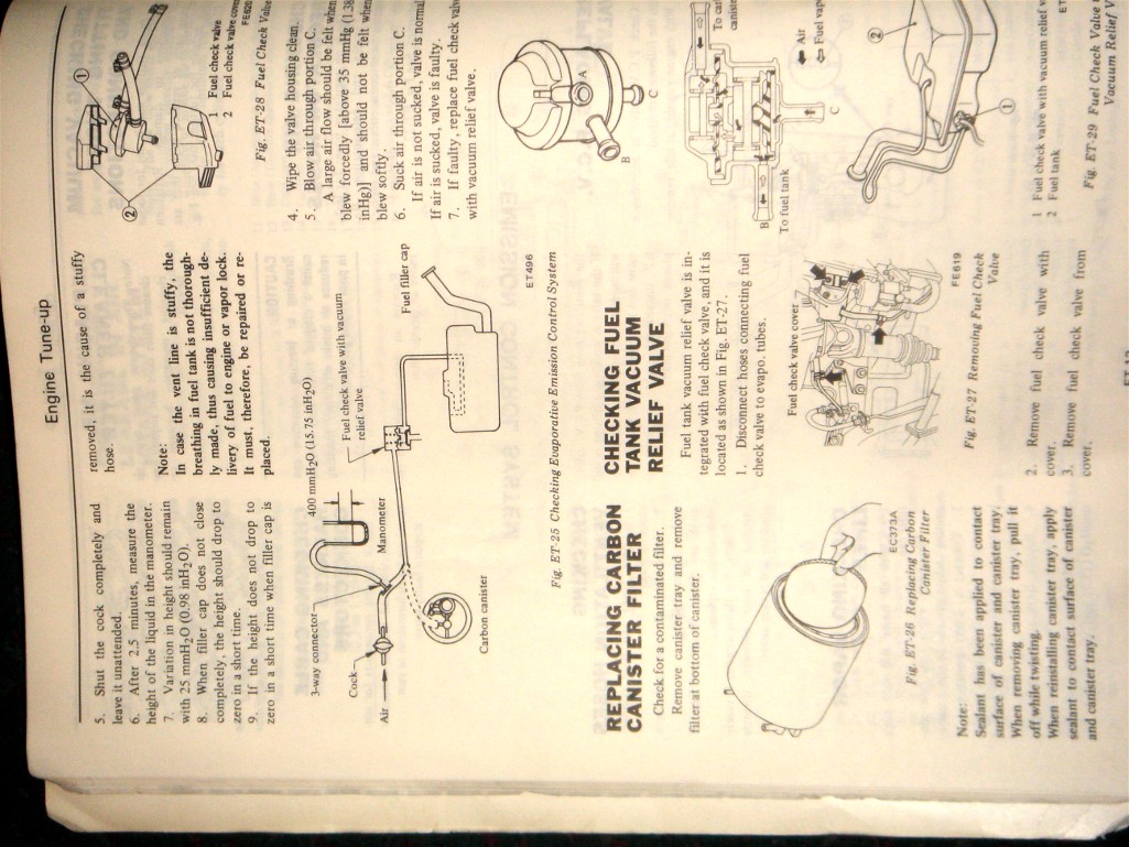

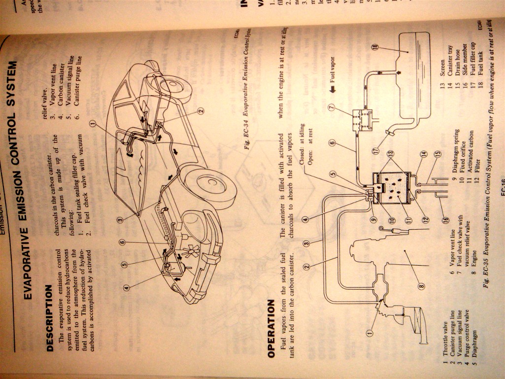

I baught a front quarter cut for my 300ZX Z32, I used stuff from it and pulled out others, untill I found a carbon canister (or charcoal canister) not sure of the name.. I don't have a carbon canister in my 280ZX and I would like to install one..
the question is, will it be possible to use the canister of the Z32 into the 280Z? I guess they all have the same configuration (Purge,Vacume and tank)??
