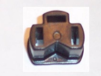

You might try Lowes or Ace Hardware in the electrical section. You'll be looking for P/N: GHG-1538 by GB (Gardner Bender) About $1.69 or so...5 grommets to the package. My plan is to use several long pieces of heavy duty shrinkable tubing to go over the wires and then seal them up where they go thru the grommet.
webdawg1

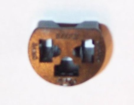

You'll be taking all three wires out of the connector. Made myself several pictures for reference purposes of the headlight connector as to where each wire goes in relation to the connector. In other words, if you had the bare headlight bulb in your left hand and you had the connector in you right hand with the wires attached, just connect the two and make note as to where each wire is going. You'll need to cut apart/seperate the wires inside the metal bulb housing as they are bonded together three across. That way when you feed them back thru the new grommet one at a time to connect them back into the connector it should not be a problem. You can use the pictures as a reference source and put the color codes for each wire in it's correct place/location. (Before you tear it apart of course....)
