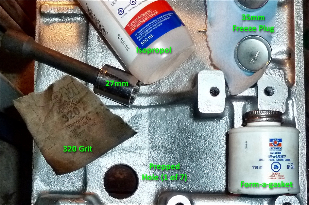

Just doing this job so I figured I would add to the site's content:
The form-a-gasket is great stuff: Cleans up with alcohol and not as messy as RTV.
I found that using a socket as a driver without the extension works best.
FYI I used the Black Dragon kit that includes the 7 side freeze plugs, the front and back freeze plugs as well as the front oil passage plug. I have read that the brass "marine grade" plugs are best as they do not rust.
Procedure I followed:
0.
Engine in normal position.
1.
Remove old freeze plug: Use 1/4" punch and hammer to drive in on the right side, grab edge with pliers and use claw on hammer against block to lever on pliers.
2.
Engine at 90 degrees on stand so that working surface with plug holes is like a table.
3.
Sand edge of hole and edge of plug with 320 grit. Wipe with alcohol.
4.
Apply sealant to edge of hole and to edge of plug.
5.
Sit plug on hole and align.
6

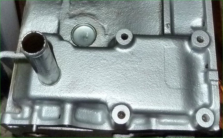

. Repeat with other plugs on same side. (this allows the first plug's sealant time to set.
7.
Drive plugs in with 27mm socket. Plug edge is flush with motor.
8.
Wipe up sealant with alcohol
