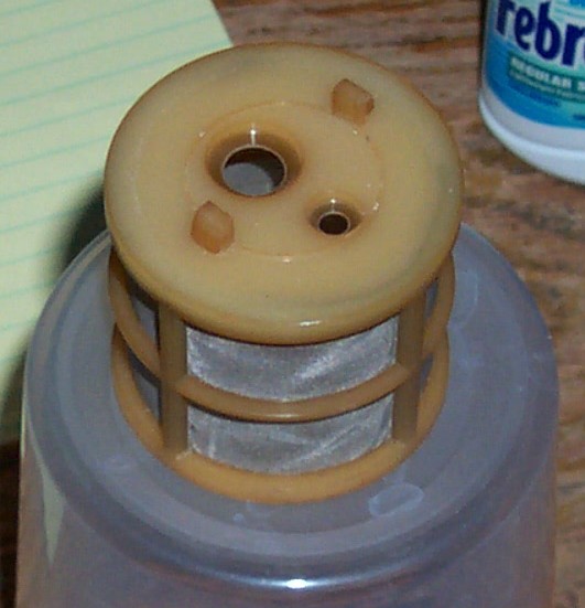

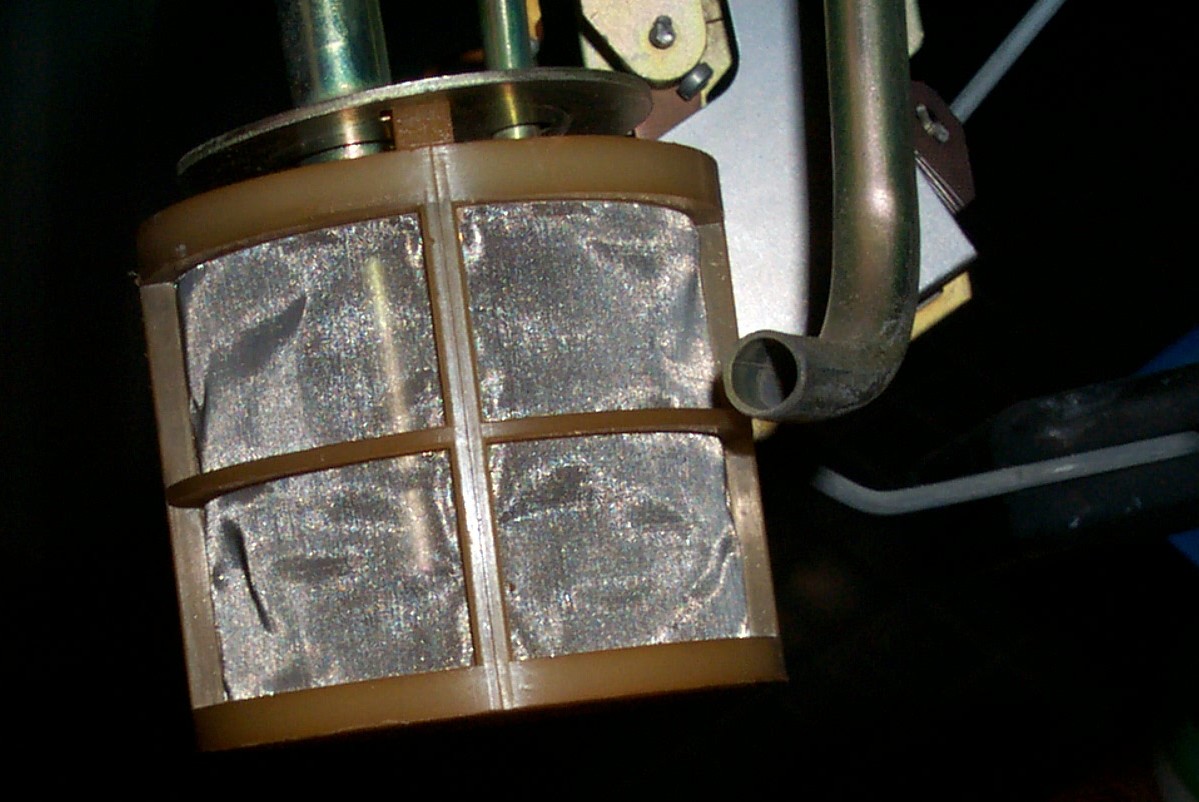

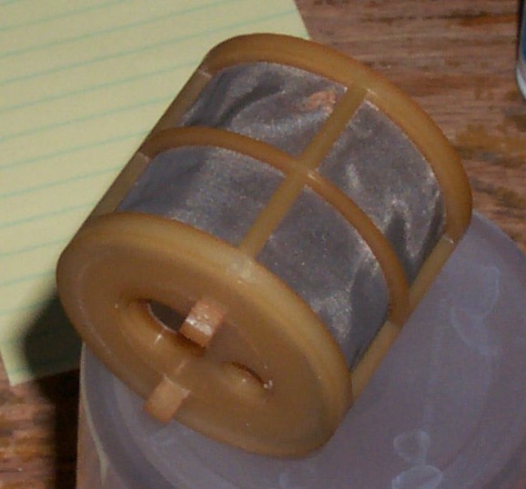

July 20, 200618 yr Author comment_175243 Thanks for the pics, A local parts shop told me that Ford used to have these filters on their vehicles. I had thought about checking the local(ish) dealership but without pictures, well, that would have been foolish.Now, though... Link to comment https://www.classiczcars.com/forums/topic/20818-what-is-this-a-3-part-question/?&page=2#findComment-175243 Share on other sites More sharing options...
