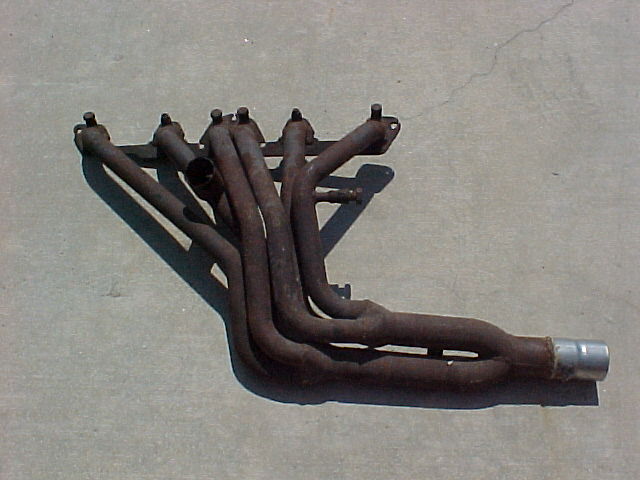

If you're interested, I have an exhaust header that I'm trying to sell. It's a 6-into-1 with a 2-1/2" collector. It has fittings for smog ports, but they have been plugged (could be drilled out and re-used if needed).
I'd like to get $65 + shipping for it.

My primary concern is still fit. My hesitation with a 6-into-1 is that the vertical is built in. Unless I am much mistaken (possible), the 3-into-2's come down at an angle, so I can alwyas shave off some of the vertical drop by cutting the 2-into-1 adapter. I appreciate the offer, but I don't think the 6-into-1 is for me =(
Yes, the vertical height (or drop) of this header is built in. But it does not hang lower than the bottom of the car. To be honest, it is a 6-into-2-into-1 header. The really is no such thing as a 3-into-2. You always start out with 6 ports. I used to have a header with the angle like you say. This one actually works better on the car. With the angled header, I actually had to angle back up slightly. The only thing that hung below the bottom line of the car was the U-bolt at the collector to pipe connection. This one allows you to run straight into the tranny tunnel. Much cleaner look in my opinion.
But hey. No hard feelings if you don't want it. Anybody else?
