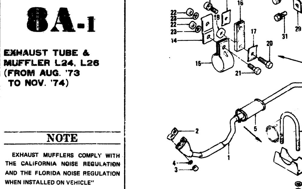

Posted July 26, 200618 yr comment_175998 Hey guys, I think I have an exhaust leak, and when I was checking it out, I saw this, which doesn't look too stock, but I'm not sure. Can anyone ID if this is a stock piece on the 260z exhaust, or if its some sort of exhaust leak fix? Thanks, Joe Link to comment https://www.classiczcars.com/forums/topic/20949-is-this-stock-or-a-cover-up/ Share on other sites More sharing options...
July 26, 200618 yr comment_176002 It is just a wide clamp. Bean dip used them on his car as well fit into tighter places and give you better flexibility. Link to comment https://www.classiczcars.com/forums/topic/20949-is-this-stock-or-a-cover-up/#findComment-176002 Share on other sites More sharing options...
July 26, 200618 yr comment_176022 Looks like a heat shield. Link to comment https://www.classiczcars.com/forums/topic/20949-is-this-stock-or-a-cover-up/#findComment-176022 Share on other sites More sharing options...
July 26, 200618 yr comment_176024 looks like the heat shild on my 280Z Link to comment https://www.classiczcars.com/forums/topic/20949-is-this-stock-or-a-cover-up/#findComment-176024 Share on other sites More sharing options...

July 27, 200618 yr comment_176219 I have one on my 260z. Link to comment https://www.classiczcars.com/forums/topic/20949-is-this-stock-or-a-cover-up/#findComment-176219 Share on other sites More sharing options...
July 27, 200618 yr comment_176224 Well xxjoeyxxeb, from the looks of your exhaust and the pic deeddee provided, it seems yours is stock. However, finding the actual leak location is another story, to which you'll just have to seek it out......or, just replace the exhaust system and be done with it. Happy hunting! Link to comment https://www.classiczcars.com/forums/topic/20949-is-this-stock-or-a-cover-up/#findComment-176224 Share on other sites More sharing options...

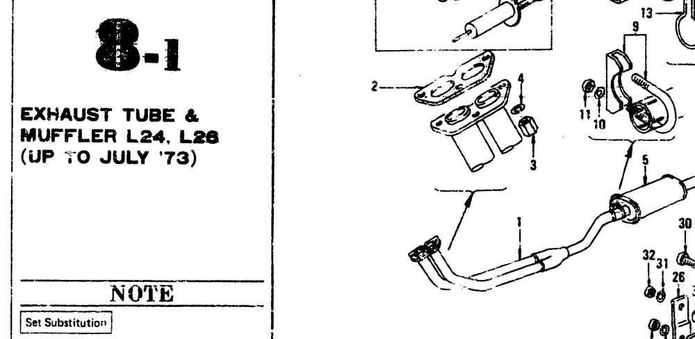

July 27, 200618 yr comment_176225 It is shown on the drawing of the exhaust system on the Parts CD for cars built from Aug 73 - Nov74. It doesn't show a seperate part number for it though. Earlier cars are shown with a different exhaust. Todd Link to comment https://www.classiczcars.com/forums/topic/20949-is-this-stock-or-a-cover-up/#findComment-176225 Share on other sites More sharing options...
