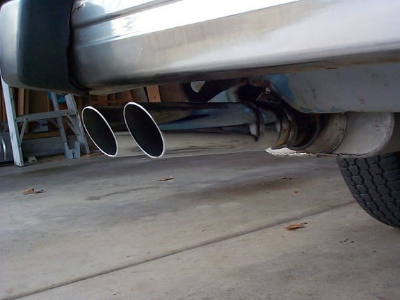

July 29, 200618 yr comment_176440 Mine is just a 2.25" pipe all the way back to a flowmaster 40 muffler on the back. Nothing special, but it sounds really good and seems to work just fine. Cost me less than $200 for all parts and labor last summer. Link to comment https://www.classiczcars.com/forums/topic/20987-replacing-the-exhaust-infoideas/#findComment-176440 Share on other sites More sharing options...

August 20, 200618 yr comment_179213 Mine is just a 2.25" pipe all the way back to a flowmaster 40 muffler on the back. What kind of tips are those? Link to comment https://www.classiczcars.com/forums/topic/20987-replacing-the-exhaust-infoideas/#findComment-179213 Share on other sites More sharing options...
