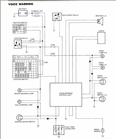

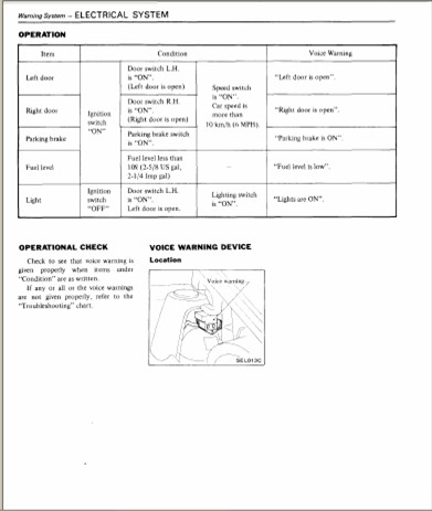

Good morning to all. As I go deeper into the Z world I have seen topics that there is a voice box within the car to remind you about open doors and such. I have looked at all of my documentation and can not find any on this as to where it is.
At present mine is not working. If some one could time me where it is located that would be helpful. My ride is a 1983 280ZX.
