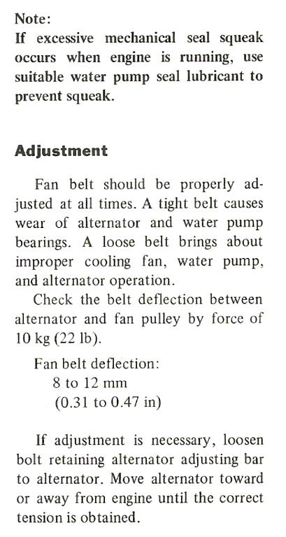

Check the tension-too loose and you will get what you have...
That's the only thing I could think of. There is a new alternator & belt, so maybe the belt could be either too loose or too tight. What is the correct "tightness?"

I'm headed over to the service place that installed my alternator to have them look at the belt. But first I'll look into the Haynes book to see what the tension should be like. "Tight" like as in the usual for a domestic car doesn't seem right to me.

From the 1978 280Z FSM, though i've never actually measured, it's sort of a feel thing. One other thing, I have found that aftermarket components, like alternators/water pumps from Kragen, Autozone etc. have a tendency to be noisy and that's anothter area where I only use OEM when available.
