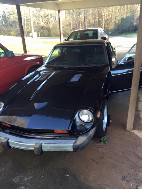

I have a 1977 280Z 2+2, and like the car in this thread it has not run for awhile - probably six years. The reason we stopped driving it was due to a strong vapor smell inside the car that we could not fix.
