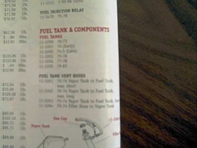

June 29, 200222 yr comment_9634 this is a pic out of the msa book, lousy camera... it says 70-73 is the same part then it changed in 74. You can almost make it out. I really need a new camera:ermm: Link to comment https://www.classiczcars.com/forums/topic/2108-73-gas-tank/#findComment-9634 Share on other sites More sharing options...
June 29, 200222 yr comment_9650 I do know the 280 tanks are larger by almost a full gallon. Not sure about the 260 tanks, the late 260 may have had the same tank as the 280 and the early 260 may be the same as the 240. When they went to FI they may have substituted the larger tank. Any tank from 73 or before should fit your 71 with no problem. Early tanks are 16 gallons, and I believe the 280 tanks are 16.8. Link to comment https://www.classiczcars.com/forums/topic/2108-73-gas-tank/#findComment-9650 Share on other sites More sharing options...
