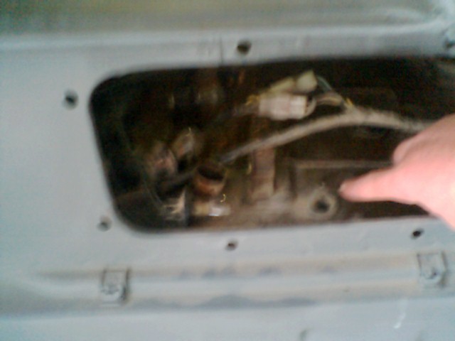

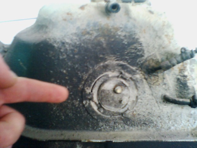

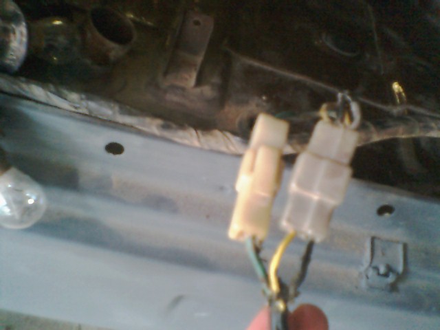

June 29, 200223 yr comment_9636 Well, its easy enough for you ta see if it would be the connection @ the sending unit with just 3 wires there. You will find the wires run through the floor in the rear hatch near the pass. side tail light. There should be three wires you can see from under the car 2 will go to the tank and one ground hooked to the frame rail close by the hole the wires come through the floor. Now I dont know about A bad con. givin you A false reading I would think if it was A bad con. it just wouldnt read. But stranger things have happend. Link to comment https://www.classiczcars.com/forums/topic/2110-gas-gauge-accuracy-electrical-or-not/#findComment-9636 Share on other sites More sharing options...

June 29, 200223 yr comment_9638 green yellow black Link to comment https://www.classiczcars.com/forums/topic/2110-gas-gauge-accuracy-electrical-or-not/#findComment-9638 Share on other sites More sharing options...

June 30, 200223 yr Author comment_9656 I really appreciate you taking the time to give me those pictures, I will be sure to check those connections out. Link to comment https://www.classiczcars.com/forums/topic/2110-gas-gauge-accuracy-electrical-or-not/#findComment-9656 Share on other sites More sharing options...

September 18, 200222 yr comment_15831 Simple test.Put a jumper wire across the two wires that are attached to your sending unit.With your switch on does the gauge go to full max?If it does then the problem is the sending unit..It's probably got rust/sediment on the float arm and or the area the contact travels on.The sending unit is easily removed by turning the ring at the unit.Of course you want to have low fuel.Shake the unit and listen for fuel in the float.That would limit its travel .There is an adjustment screw on the sending unit should all be well with the unit.Perhaps age has caused increased resistance in the path from sending unit to gauge or the connectors at the tank need cleaning.I rub a little oil on the rubber gasket to aid reinstall and prevent tearing.The fact that your gauge moves and is stable not floating around I believe it is good. Have fun!! Daniel Link to comment https://www.classiczcars.com/forums/topic/2110-gas-gauge-accuracy-electrical-or-not/#findComment-15831 Share on other sites More sharing options...
