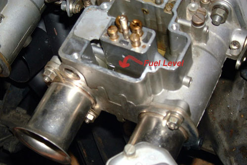

I've checked for fuel - pulled off all three weber dcoe 40 covers and looked inside and the fuel level is identical in all three and pictured below.

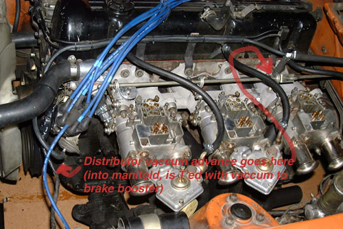

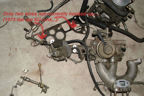

I had the full '73 flat top su shenanigans on there up until last night when I yanked them off.... the only two wires that were plugged up then but no longer are now are the backfire valve and the XXX??? valve (see pic below also...)

Does the fuel level look correct?
Mike - like I said the only two wires I have unplugged are the backfire valve and the other valve pictured above (emissions?)

look at the 4th picture down... go straight back (towards the valve cover) from where the jets are on any of the three carburettors... see that lever that is poking up and to the right (ie towards firewall) it looks like it should have a wire?? or something going through it which would then pull it forward (towards the radiator)...
lemme see my weber exxploded view....
brb....
oh yeah it's called the choke cover.... :stupid:
is that supposed to be hooked up? how? they are REALLY hard to move.... should they move freely? should they be moved towards the radiator (ie forward) for the car to start? why did I think webers did not need chokes????? How do you hook them up?? i know, I know.... lots of questions.....

Your fuel level in the bowls looks OK - but that is no way to measure them. You really need to set the float-height accurately as per the diagram in the Weber gasket kit. You need to bend those tabs on the float for both open and closed positions. Float height and consequently fuel bowl level is VERY sensitive on the Weber DCOE. Please do not underestimate this. The Webers are precision measuring devices, and will not tolerate any inaccuracy in set-up. You have the "old" style brass floats, in keeping with your "old" style "flat-top" pre-emissions DCOEs ( thats good ), but they can be fiddly to bend the tabs up and down on.

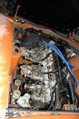

I can't quite make it out ( maybe tired eyes ) but how have you connected the fuel supply for each carburettor? I can see the "front" two have got hoses on them individually, and I presume that the third one has too - but what are they connected to?
If you are using your old standard-spec. metal fuel-supply rail, then it only has two OUTlets for the old SU carbs. The other ( smaller diameter ) pipe is the return to the tank. I am worried that the final carb is connected to the return pipe - I hope that I am wrong.
Anyway, you might like to try blocking-off the return pipe until you get the problem sorted, as if it is still operational it is losing you fuel pressure from the stock mechanical pump.
With a single electric pump rated at around 3 to 5 PSI, you would be able to delete the stock fuel rail and use either the NISMO fuel rail for triple carbs ( three outlets and no return ) or run your own flexible fuel pipe from the pump or filter up to the carbs. As long as the pump pressure is not too high then you would not need to have any return pipe whatsoever ( but you need to block the return to the tank, otherwise you will get a fuel leak if you overfill the tank or park on a slope.... ).

A.) Try removing and plugging the vacuum advance. Make sure your brake booster vacuum line does not leak.
