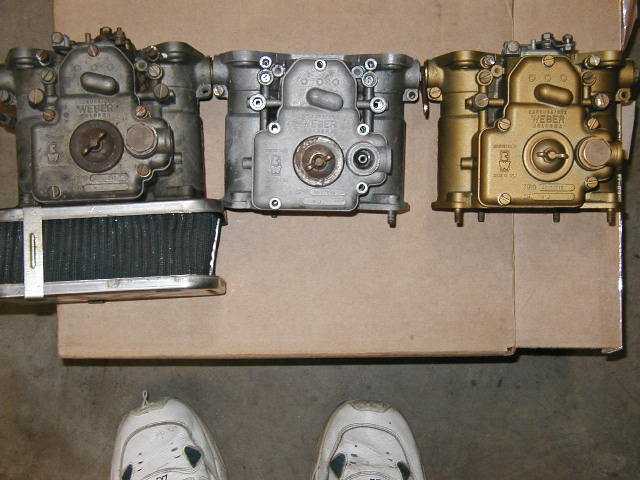

July 1, 200222 yr Author comment_9728 thanks for all your replies guys....i'll answer all as best and concisely as i can.i'll first check the condition of the set of isolators I got before i order more - incidentally it is from pierce that all my rebuild parts came from....ben9090 sure i can check timing on it again to be sure...alan the fuel rail that came with the triples was steel as per stock but of course with three outlets, i don't think it was the nismo unit you mention because it does have a fuel return end as the stock SU fuel rail does.also alan: yes the spark plugs are in the correct order - i did not remove them during the installand yes i did take them apart myself, clean every item i could get my hands on with fuel/carb cleaner before re-assembling... i tried to make some progress with the choke cover/starter devices but didn't get very far...AND since I found nothing specific about them in my literature I didn't bother with them all that much... guess I'll go right back to them then....PS: If all else fails, does any one recommend a Weber go-to person/shop in the LosAngeles area I could take them to for a more qualified opinion then my own?-e Link to comment https://www.classiczcars.com/forums/topic/2112-triple-carb-install-wont-start/?&page=2#findComment-9728 Share on other sites More sharing options...

July 3, 200222 yr Author comment_9868 Ok here's what is new: first i pulled off the top covers and re-checked the range of motion of the floats. I am SURE I have the droop set to 15mm on all three. I will admit to having trouble setting the closed value to 7.5mm (in point of fact I think they hover more around 5mm)... which leads me to the first set of questions: _ to set the floats at the right droop you bend the tab which hits the needle right, and to set the right closed value you bend the brass arms the floats are at the end of, right? or vice-versa? do you guys have a good trick for bending the requisite pieces? second I forgot to mention that my car came with an aftermarket external electric fuel pump located outside of the tank (it actually hangs underneath the car betweent the tank and the spare tire well) so there ought to be no fuel pressure problem third with the covers still off i made a little experiment with the accessory power on (and fuel pump on of course) to see if movement of the floats did correctly allow fuel to flow into the bowls - no problems there whatsoever. while i was at it i also checked over what Alan called the "starter devices". They were indeed stuck in the off position. The front two carburettors were stuck much more than the last one. Well I got them loose and moving relatively smoothly. After doing so I pushed them back to their off position (towards the firewall, not towards the radiator) then i refitted the covers and turned the accessory power back on and with mirror and flashlight watched down the the bores of each carburetor what happened when i turned the throttle open by hand. Here's the first WEIRD thing which to me indicates that I do not understand the functioning of my Webers very well... If I waited long enough with the fuel pump working then I would eventually get quite a bit of fuel dribbling out of the "jet" (correct name?) inside the chokes of each barrel of the front two carburettors. The back one did not have this problem provided I didn't pump the throttle arm. So let me make this crystal clear: with the electric fuel pump doing its thing, and if you wait long enough, and you do not touch the throttle, fuel will drible out of the jets inside the chokes of both barrel of each of the front two carburettors. I think that because of the amount of fuel dribbling in these two the car would not start because it would automatically flood itself the minute I pressed on the gas. So i got a can of starting fluid as was recommended by both Mike's. I sprayed that into all three carbs and tried to start the car again. It almost INSTANTLY came to life and boy was it LOUD... BUT: I had to almost immediately shut off the engine because the revs came up very very fast and almost instantaneously.... I tried a couple more times and the same thing happened. I don't think it was because of the ether (starting fluid) alone... What I think is happening is that the ether helps it kick over but then with all the fuel dribbling out of carburettor 1 and 2 the engine wants to go to wide open throttle right away... I shut it off almost immediately on all three occasions because the revs in those couple seconds showed NO sign of slowing down or petering off... If I left it on I was afraid it would rev to god knows where and drop a valve.... So..... (sorry for the ultra-long msg) I understand the needle valve along with the floats regulates how much fuel is in the bowls at any given time. I understand the main jets get their fuel from the bottom of the well, below the bowls. But how does opening the throttle make the main jets squirt fuel into the barrels then and only then? Vacuum? And is the fact that I am getting this dribbling problem a result of the fuel level in the bowls of carb 1 and 2 (my floats' closed position not being set correctly) being too high??? Thanks a mil friends, -e Link to comment https://www.classiczcars.com/forums/topic/2112-triple-carb-install-wont-start/?&page=2#findComment-9868 Share on other sites More sharing options...

July 4, 200222 yr comment_9888 I have had those o-ring gaskets and one thing I want to say is once you get them in there and torque it down. If you ever take it apart, the rubber o rings no longer fit into the spacers. You really have a heck of a time re-assembling it. I bought HKS solid spacers, very costly, they are brown and made of phenolic. The have gaskets on both sides and are solid so you don't create further problems with the carb linkage. Having orings in there causes the carb to manifold interface to be not so solid. Like your pics show, you are running the system w/o air cleaners? I had a similar problem as yours at one time because I had installed the ITG filters on incorrectly blocking the floatbowl breather holes. That allowed the car to turn over but not run more than a couple seconds.If you install a electric pump, get a good one. Those cheap things from Kragen burn out every year or so and leave you stranded. I opted for using a old Mazda RX-7 pump, mounted inline near the gas tank. They are low psi and you can get them from the junkyard for $10 a piece. At that price, get two and have spare.A pump like that you can run w/o a regulator as I have done but it is always better to be precise as possible with a regulator. Link to comment https://www.classiczcars.com/forums/topic/2112-triple-carb-install-wont-start/?&page=2#findComment-9888 Share on other sites More sharing options...
July 4, 200222 yr comment_9891 Got around to reading your questions more carefully - as for setting the float level, I try not to bend the float arms themselves much at all, but only the tabs. I take the float off and bend the short arm (for the level) and the long arm (for the droop) toward each other just a little too far, then I put the float back on the lid and flex things around until it matches the specs. I used drill rod of 5/16 (level) and 9/16 (droop) because I don't have metric drills. With these I iterated back and forth to set the levels. I takes perhaps 5 minutes per carb if you remove the lids and work on a nice bench. My carbs are brass-float 40DCOE18s on a Cannon manifold. All the jets and other calibrated parts match what the Haynes Weber book lists as the parts included with the stock Weber conversion kit. Engine is L26, mild port/polish on E88 head, mild Schneider 274 cam, N42 280Z exhaust manifold and head pipe only (like you, I do not have the exhauist fabbed yet). I have the stock 260Z fuel rail (2 outlets) and I have the return line hooked up. Alan seems to think this is not optimal, but I am telling you this only because my car starts and so I don't think it is your main problem. I have the stock electric pump and a Purolator style electric pump in the engine bay, the mechanical pump removed, and the regulator set to 3 psi. Not optimal, but again my car starts OK. My floats levels are set, but the car started even when they were WAY off. My idle screws are 3/4 turns out. The car starts no problem without the starter valves, much like Alan described - 2 pumps and 30 seconds of nannying the throttle. My timing is 10 deg BTDC with vacuum advance disabled. I have done no synchronizing, jetting or mixture adjustements yet. Things that made the car NOT START until I fixed them: -Weak stock ignition coil -Vacuum leak through the distributor advance dashpot. I would block off both brake booster and dizzy vacuum just to make sure. I have the unpreferred o-ring style gaskets, but I got new O-rings and used elastic stopnuts ordered from www.McMaster-Carr.com. At all times the car at least popped and fired, however. -Mark Link to comment https://www.classiczcars.com/forums/topic/2112-triple-carb-install-wont-start/?&page=2#findComment-9891 Share on other sites More sharing options...
