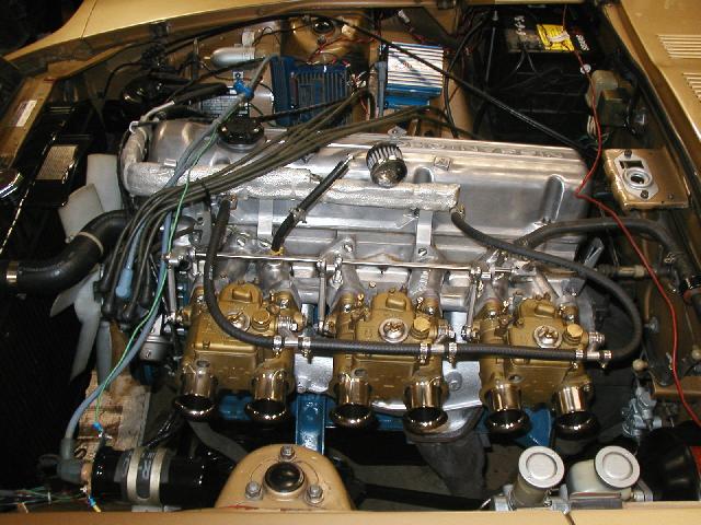

July 4, 200222 yr comment_9934 Hi Mark,Happy 4th of July to all you rebels over there. I have to say that I feel we really ought to have a National Holiday over here in the UK to celebrate the fact that you dumped us.............Sorry to hear that Webers are akin to Unicorns in your neck of the woods, but actually it seems that people are frightened of these little jewels the world over............ The problem that you describe certainly sounds like an Accelerator Pump Jet problem ( too much gas being dumped in when you hit the throttle ) - but that might be due to something else. I am wondering about your Accelerator Pump Rod stroke................Your Needle Valves also sound a little large ( not that this would necessarily affect this particular problem ) and the standard size in the rebuild kits is 1.75. Maybe you might consider changing them back in the future........From your photo, I can see that your old brass-float "Flat-Top" ( pre-emissions type ) 40DCOE-18's are just perfect for a mildly tuned L24 / L26 or even L28. However, I hope that this is a "before" picture, and that you have rebuilt / cleaned / restored them by now! I also hope that you have re-attached the Starter Device to that centre carb - as its missing in the photo. Weber themselves even recommended the 18 series as the best choice for the L24 / L26 engine. Your jetting sounds just about optimum for a BASE LINE setting - but do remember that each individual engine is different, and a proper rolling-road dyno set up would probably change some of those jets to fine tune your particular needs. You CANNOT do this off the page and expect to be spot on. Remember that these sidedraught carbs are PRECISION measuring devices, and just a single step up or down in jet or air corrector sizes will make a very noticeable difference to your state of tune. Like I say - it needs an expert to set the final percentage. You have to figure the cost of this into the conversion. I took my last built engine ( which I thought was running pretty good ) to a dyno tester and we put it on his rollers. He ran it up and we saw a peak of 158 bhp at the rear wheels, but it sounded a little "fat". He told me to go and get a coffee and come back in half an hour. He changed the accelerator pump jets, the mains and the air correctors ( leaning the engine out through the Accelerator Pump stroke and through the transition onto the Main circuit ). Final figure was 167 bhp at the rear wheels and much improved driveability. I could not believe how the car was TRANSFORMED on the drive home; it really sounded crisp and seemed to be another engine altogether. As I say - the changes were very small indeed.............In your particular case, I am wondering of you are trying to put the cart before the horse - so to speak. It seems, unless I misunderstood, that you have not yet got your full exhaust system hooked up to the car. If this is indeed the case, then its much too early to judge anything yet. If I misunderstood, and you have in fact now got the full system connected - then it might be worth checking your Accelerator Pump Rod stroke ( thats the little rod thats got a little hook on it and attaches to the Accelerator Pump Piston. It is pushed up by that little cam connected to the spindle, under the cover at the "back" of the body ). The recommended Pump Rod stroke is 0.394 ins. ( 10mm ) and you can measure this by taking off the top cover of the carb and actuating the throttle. You can measure the actual stroke of the rod. This Rod stroke is the thing that measures the duration and timing of the Accelerator Pump shot ( not the amount of fuel it pumps - which is governed by the size of the Accelerator Pump Jet itself ) and it makes a HUGE difference to the driveability of a carburettor conversion on a particular engine type. If the Pump Rod stroke is any more than 10mm then I recommend that you buy new ones and change them.All this "advice" I am giving is deeply ironic; my present car is running Mikunis! They just seem more "correct" for the Japanese-spec. theme of my car. However, I do have to say that they are not superior to a good set of early DCOE's in the performance department. The Mikunis do not have such a good "transition" as the Webers ( when the main circuit takes over from the accel. pump ) and this is probably connected to the design of the Accelerator Pump itself. These carb postings really give you good typing practice........I wonder how Eric B is getting on? Happy jetting all,Alan T. Link to comment https://www.classiczcars.com/forums/topic/2112-triple-carb-install-wont-start/?&page=3#findComment-9934 Share on other sites More sharing options...
July 5, 200222 yr comment_9938 No, its true I don't have the full exhaust hooked up. I was a little afriad to turn over my 6-barrel flamethrower to the exhaust shop with no brakes. I have unspeakable brake problems, but as a brake engineer I'm hoping I can fix them without requiring assistance from Europe . I would be happy to take my car to a dyno and have an expert such as the one you describe work on my car - unfortunately, I don't believe such a Weber expert exists for more than 1000 miles. I did some road testing at fixed RPMs, but the results were inconclusive. I'm afraid the ultra-hot Jacobs ignition is burning the plugs clean even though I feel am richer than hell. I should say, my needle valves could very well be what you describe (1.75 v. 2.00) - to clarify, those parts that are MARKED I checked with the manual and found them to be the same as those (hence alleviating me from having to write them down somewhere). EricB is probably eating and socializing with family for the July 4 celeb!!! Some pics to follow. -Mark Link to comment https://www.classiczcars.com/forums/topic/2112-triple-carb-install-wont-start/?&page=3#findComment-9938 Share on other sites More sharing options...

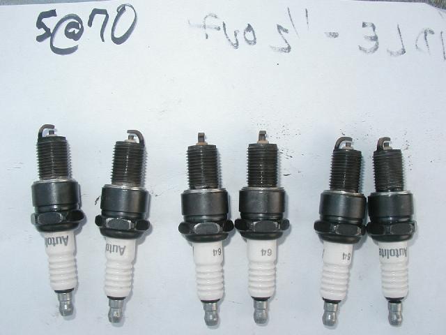

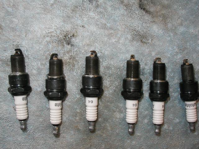

July 5, 200222 yr comment_9940 An example of my plugs after idling for 5 minutes. Idle mixtures at 3/4 out. Resultant action taken was 1/4 turn in on #6 (left most) and 1/8 turn on #5 (second from left). Link to comment https://www.classiczcars.com/forums/topic/2112-triple-carb-install-wont-start/?&page=3#findComment-9940 Share on other sites More sharing options...
July 5, 200222 yr comment_9941 5 mins running at 70 mph/3200 rpm - plugs oriented such that darkest color faces camera. I also took pictures from 4th gear part-throttle acceleration, which burbles and barely accelerates ... they didn't come out, but they looked exactly like Haynes manuals tell you a healthy spark plug should look - though I feel it must have been rich as hell! -MB Link to comment https://www.classiczcars.com/forums/topic/2112-triple-carb-install-wont-start/?&page=3#findComment-9941 Share on other sites More sharing options...
July 5, 200222 yr comment_9942 5 mins running at 70 mph/3200 rpm - plugs oriented such that darkest color faces camera. I also took pictures from 4th gear part-throttle acceleration, which burbles and barely accelerates ... they didn't come out, but they looked exactly like Haynes manuals tell you a healthy spark plug should look - though I feel it must have been rich as hell! -MB Link to comment https://www.classiczcars.com/forums/topic/2112-triple-carb-install-wont-start/?&page=3#findComment-9942 Share on other sites More sharing options...

July 5, 200222 yr comment_9949 Benn9090Hey, those carbs look great! What kind of finish did you apply to them? I used to build airplane engines too, and we used Alodine to protect bare aluminum from corrosion. Looks similar.As far as the poping goes, that could be your distributor. Since you were fiddling around with the vac. advance, there may be something else not right in there. I'm not up on vac. adv. units as we always disable them for racing. However, I have cured some Z track cars that stumbled and popped by going to a locked breaker plate, and using only mech. adv. setting total advance to 34-36 degrees. I'm not advising you do this, I mention this only to point out theres more than one way to skin a Z.More to the point, there are a number of sensor/gauges on the market that will take the guesswork out of what your doing. K&N among others, has a air/fuel ratio monitor, or a device called a Lamda indicator which uses oxygen sensors to indicate air/fuel ratio(ideally around 14.7:1) Or a good old Exhaust Gas Temp. gauge. (EGT) We use EGT and fuel flow to determin proper Mixture settings on an engine dyno. Hang in there. I think your about to become the local Weber expert in your area.Phred Link to comment https://www.classiczcars.com/forums/topic/2112-triple-carb-install-wont-start/?&page=3#findComment-9949 Share on other sites More sharing options...

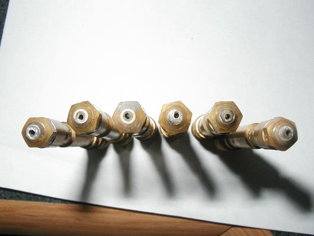

July 6, 200222 yr comment_10042 I think I found something. It looks like my main jets have been soldered and redrilled -- Link to comment https://www.classiczcars.com/forums/topic/2112-triple-carb-install-wont-start/?&page=3#findComment-10042 Share on other sites More sharing options...
July 7, 200222 yr comment_10053 Benn9090,I assume you have already ordered a new set of main jets.The makers of jets have always said never to drill jets. I used to figure they just wanted to sell more jets. But every time I run into drilled jets, they never seem to be running right. Hope that cures your problems.Phred Link to comment https://www.classiczcars.com/forums/topic/2112-triple-carb-install-wont-start/?&page=3#findComment-10053 Share on other sites More sharing options...
