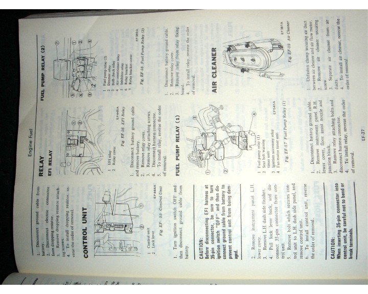

where is the ing. relay located there are alot of relays
The fuel pump is located in back, next to the gas tank, so that is not the clicking you hear.
I've attached a photo out of my FSM, perhaps it will help with your problem.
If you would like, I will email you all 56 pages from my manual, PM me if you want to take this option. Our cars are different years, some things WILL be different, but it may send you in the right direction.
If you haven't yet, get yourself a factory service manual (FSM), it is much better than Haynes or Chilton, although those are good references to have as well.
thanks everyone for all your help. Zcar owners RULE.replaced my ing. starts every time. now i tryed adjusting my tps very touchie it idls great but when i take it out on the road it kicks and bucks. i have spark plug wires comming tommorow. i hope thats it. any other sugg. thanks again to everyone who helped me along i never would have had the courage to do it on my own without your support.Zcars rock
